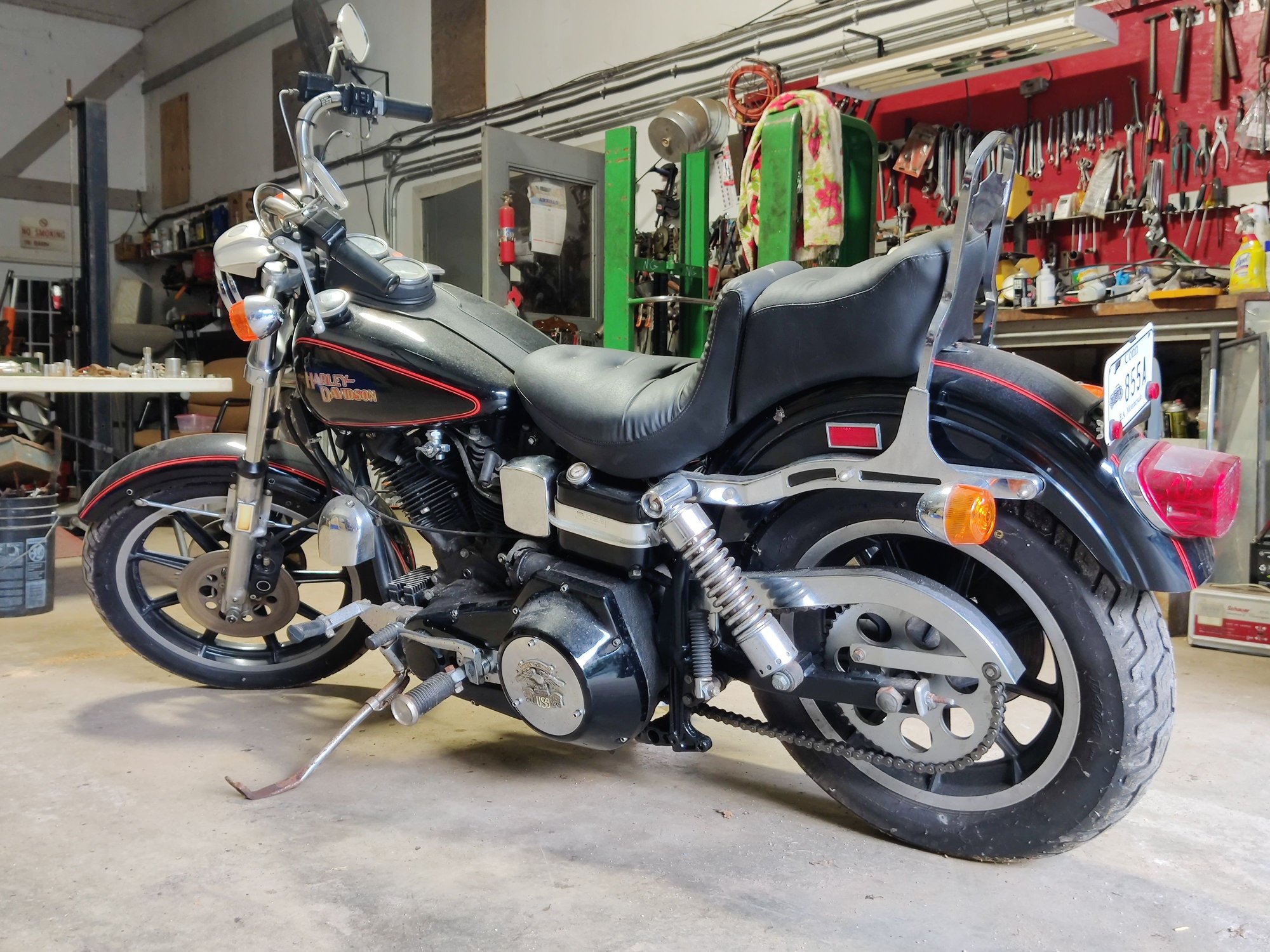

Here's a pic I snapped the other day after a quick wash
