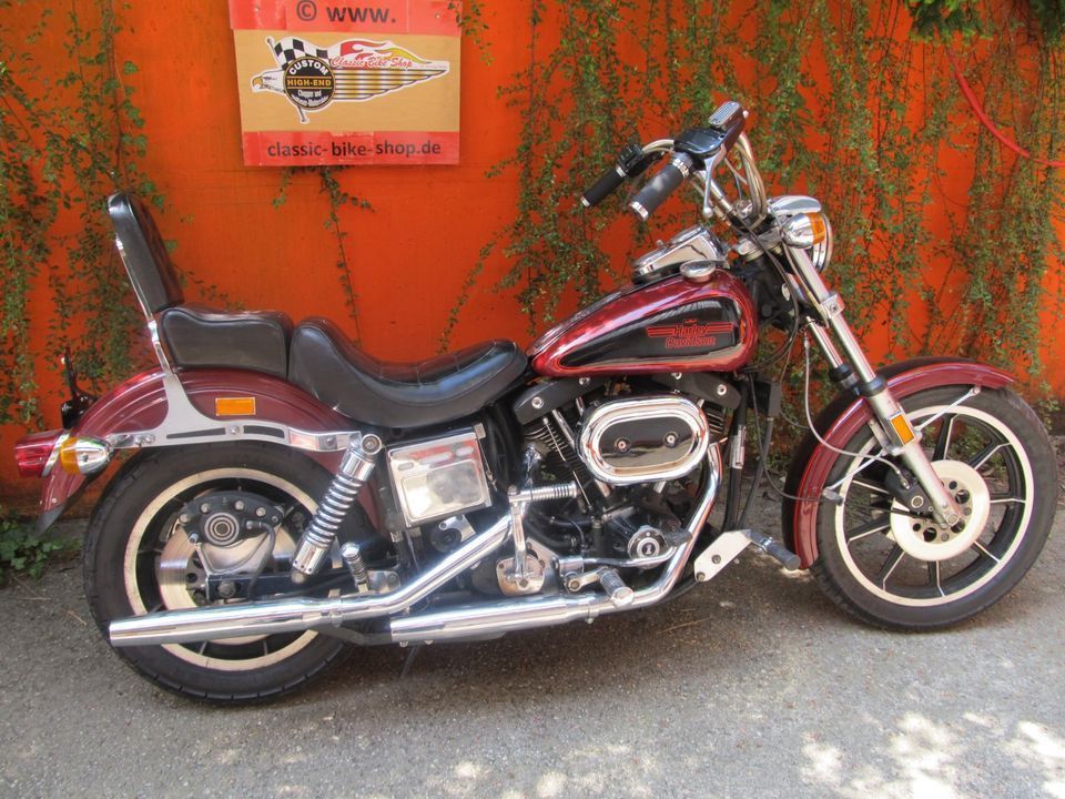

Hi Ken,
heres a 1981 that looks pretty much in original unrestored condition , i included a close up of the rear reflector position it looks like it sits just about half way over the fender strut bolt , i put my reflector on my fender after the fender was installed to get it in the right position !
the European models have yellow rear reflectors in stead of red ones . . .
here you can see that the reflector sits just about centered above the fender strut bolt . . .

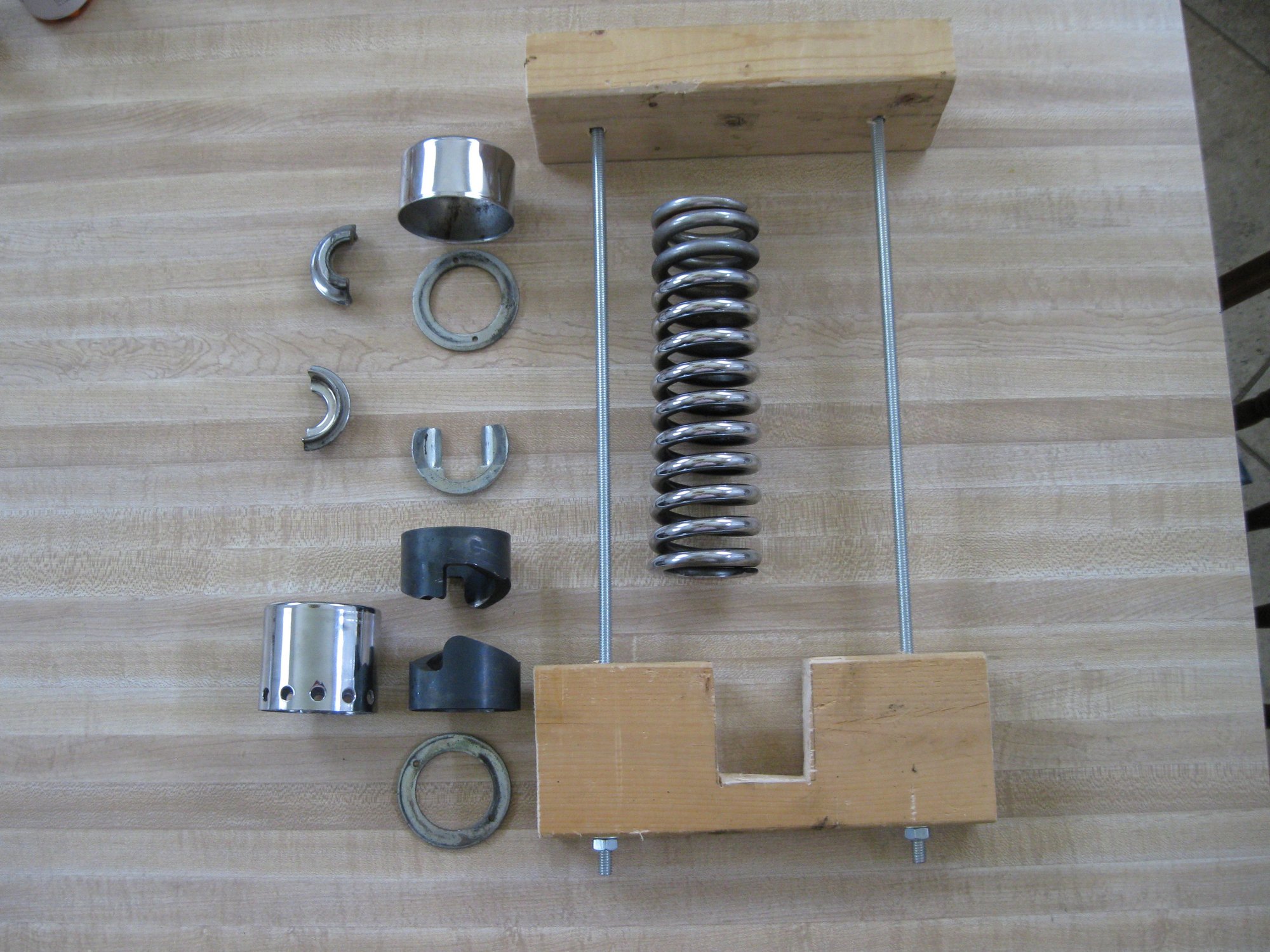

Finished up my $5 shock jig, going to get one shock assembly done today.
