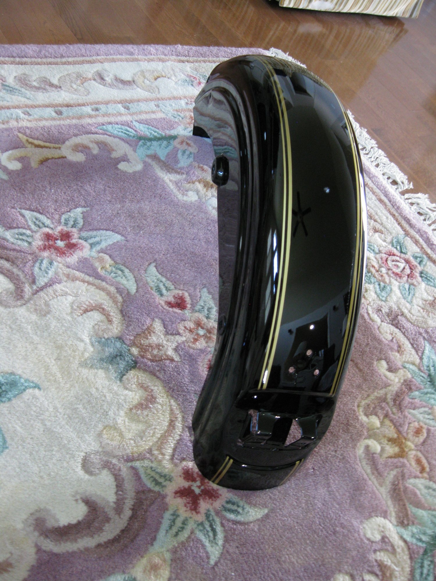

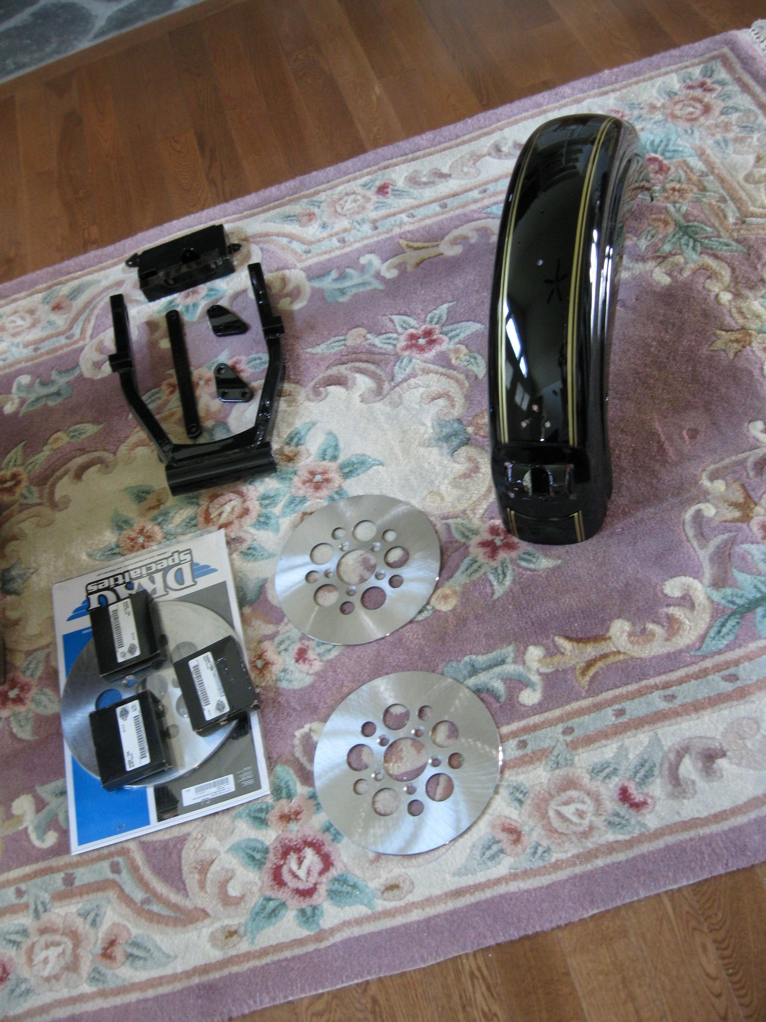

New fender is finished.
"Some assembly required"

It always fells great when a plan comes together - good luck in the install

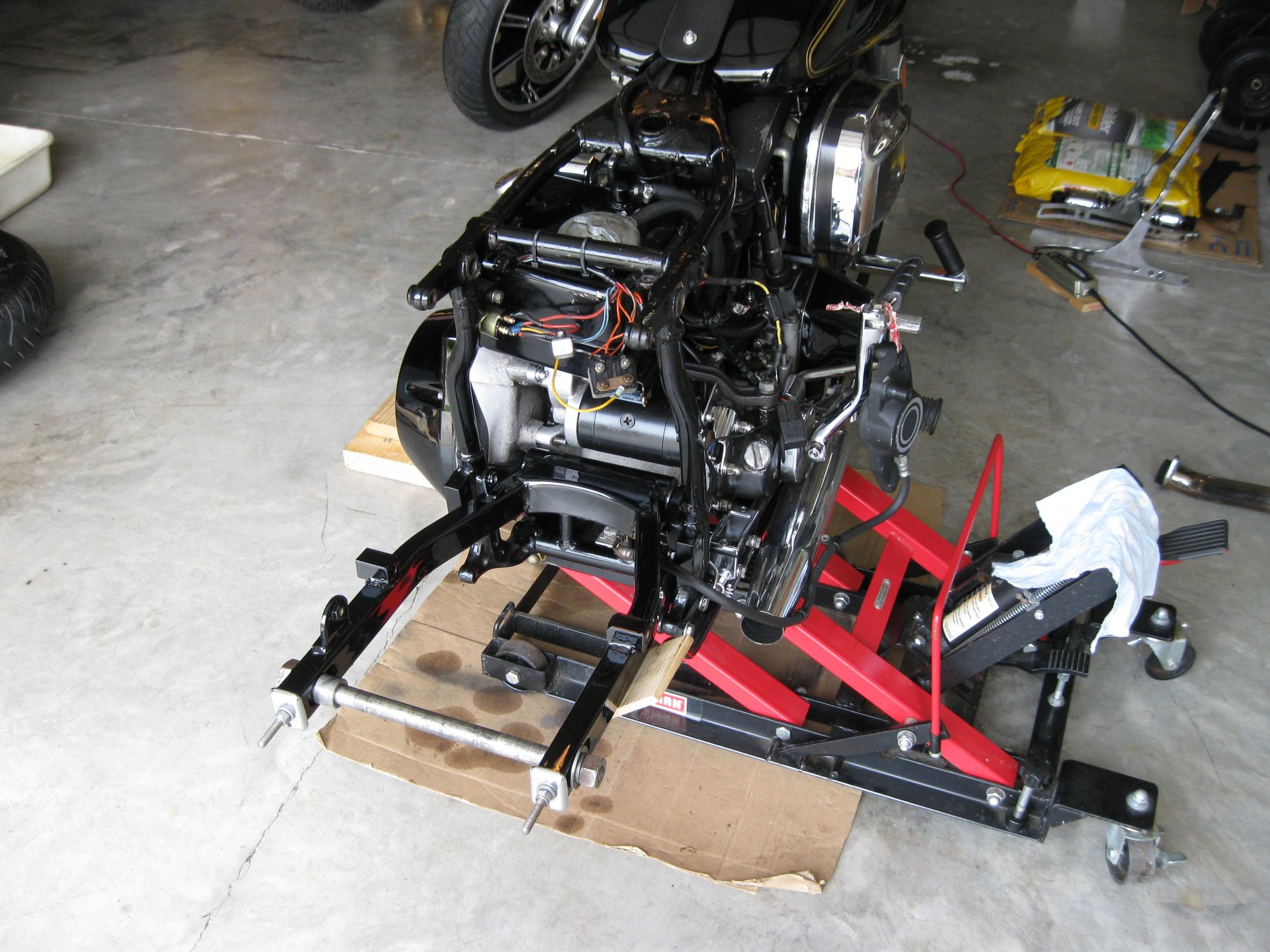

Got a little more done, swing arm on and some parts cleaned. My riding mower needed major maintenance and a repair so I did this on the bike while I wait for parts for my lawn help.
