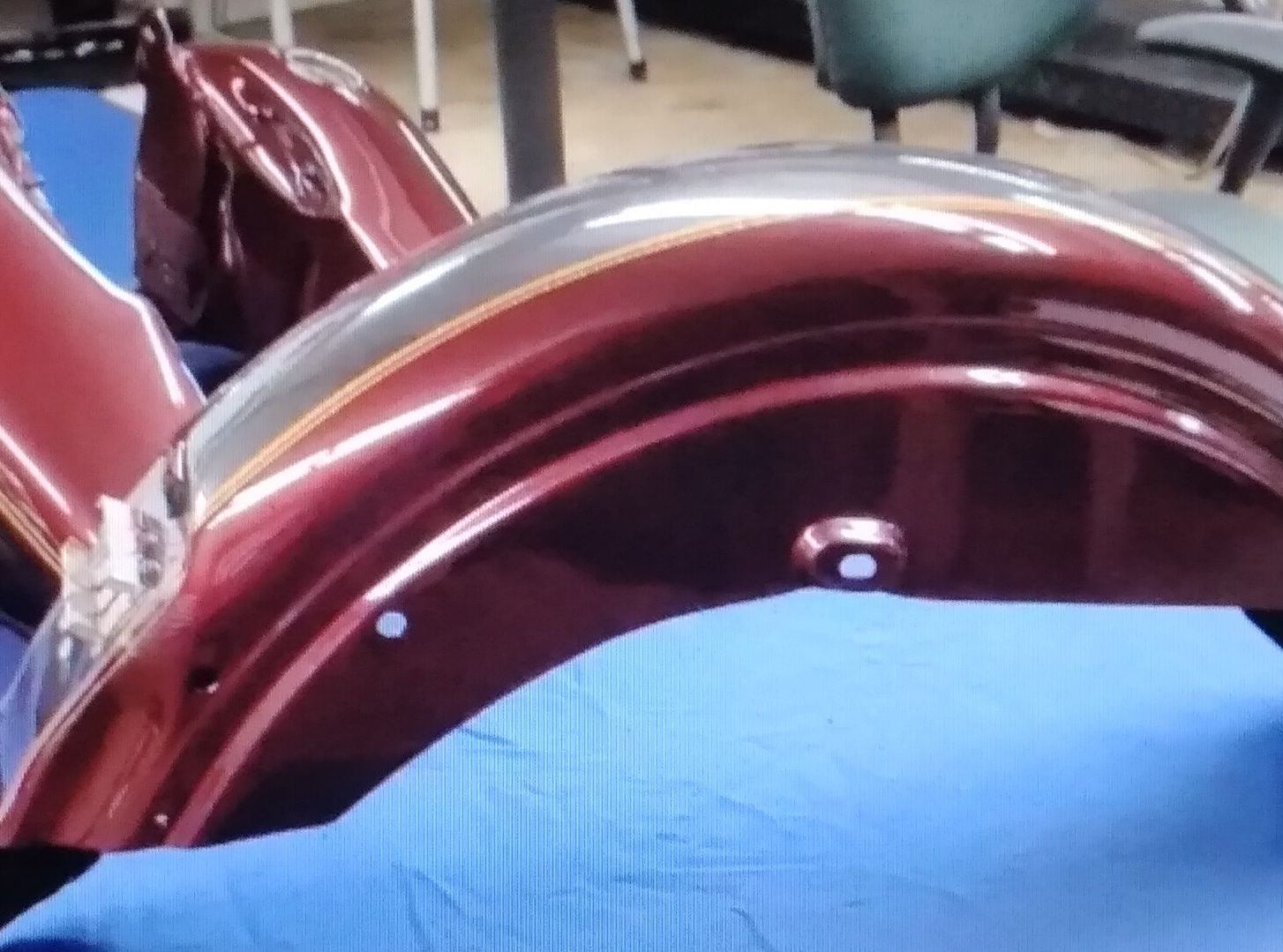

heres my rear fender from my 85 FXSB Low Rider !
Thanks Troy.... I guess I did Not know the Designation of the '85-'86 Fat Bob (I guess I believed there was Only the Fat Bob, and the WideGlide) ... But I would have guessed they still had the Bump in fender. While the FXWG from '85-'86 does Not (the one here don't anyway)
So... FXS all had the Bump?? FXWG No Bump..?? FXE, & FXEF, Who Knows??
Edit; Duh on Me... looking at the Parts catalogs..I am going to assume that from 1978 (1977 for the Low Rider FXS) on all SuperGlides used the same rear fender...With Bump!!!

My '84 FXE has the bump in the rear fender.
