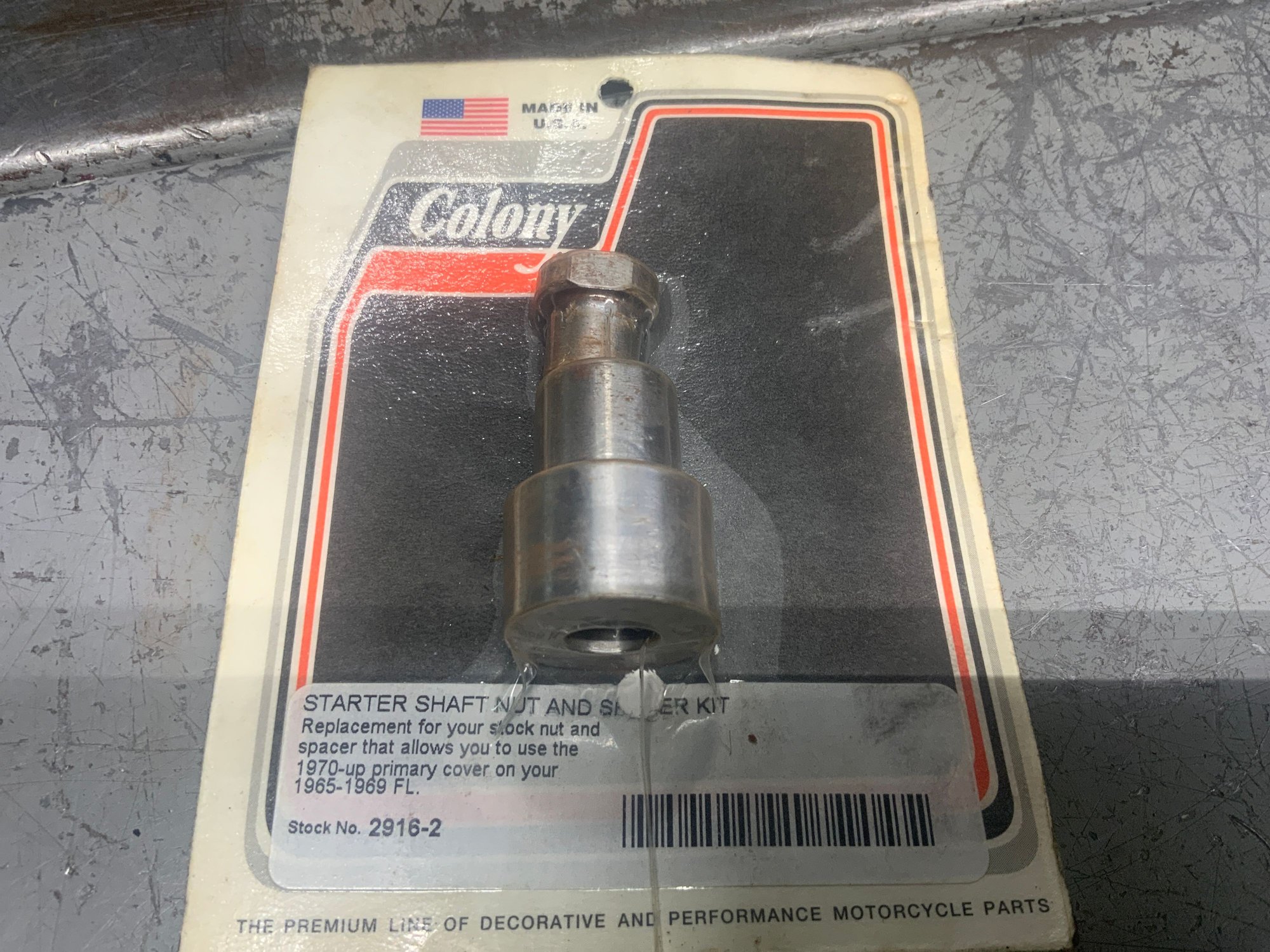

Panz Yes I installed the washer that goes on the starter shaft. I have a later outer primary with a removable derby cover on at the moment along with the starter shaft extension in case I need to get at the clutch adjustment. I have the original outer primary with the screw cap to grease the compensating sprocket that will go back on when I'm sure I've gotten the clutch sorted out.

That’s it — the later primary can be used BUT you need the extension starter end spud is special to use it
