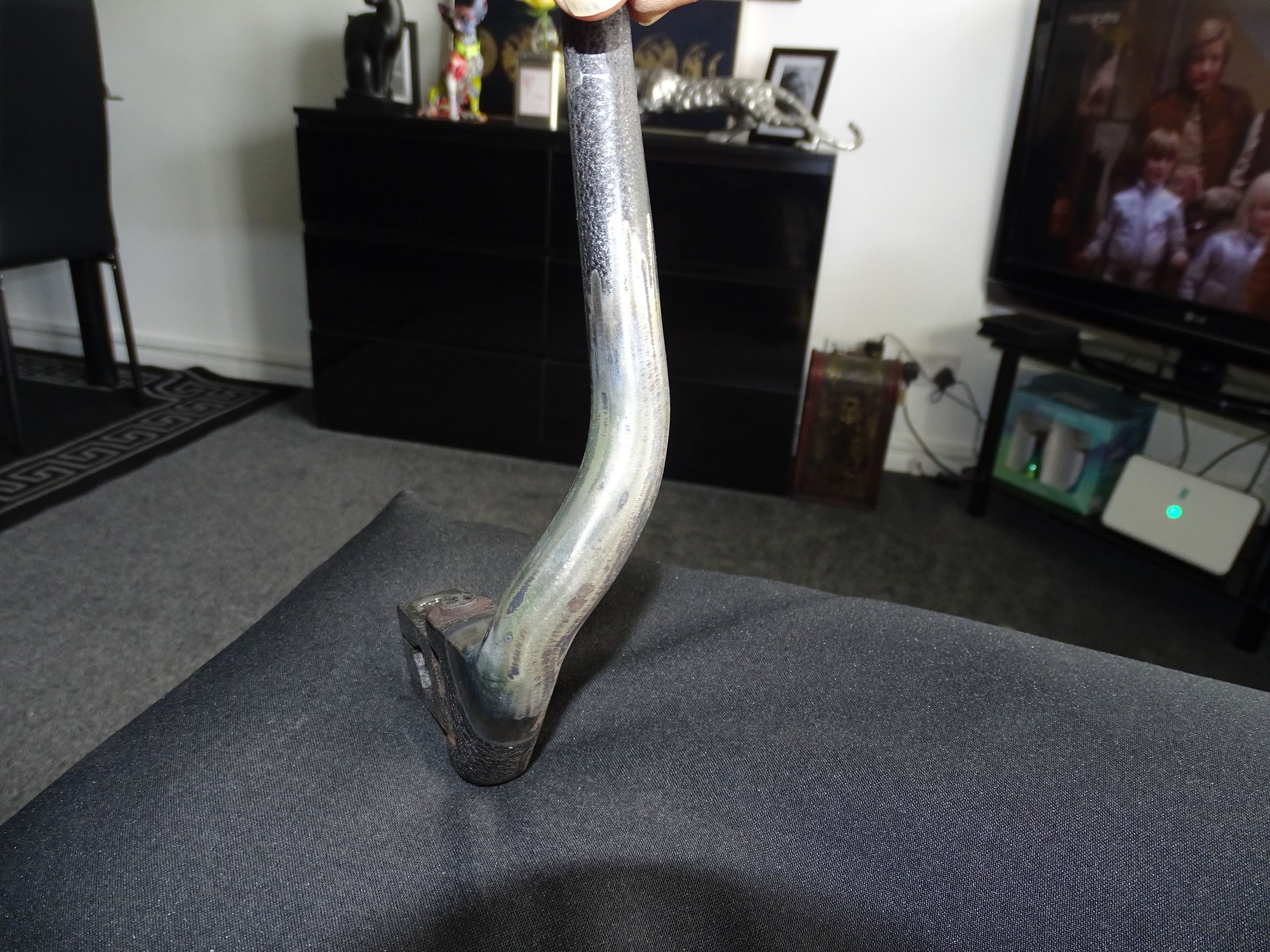

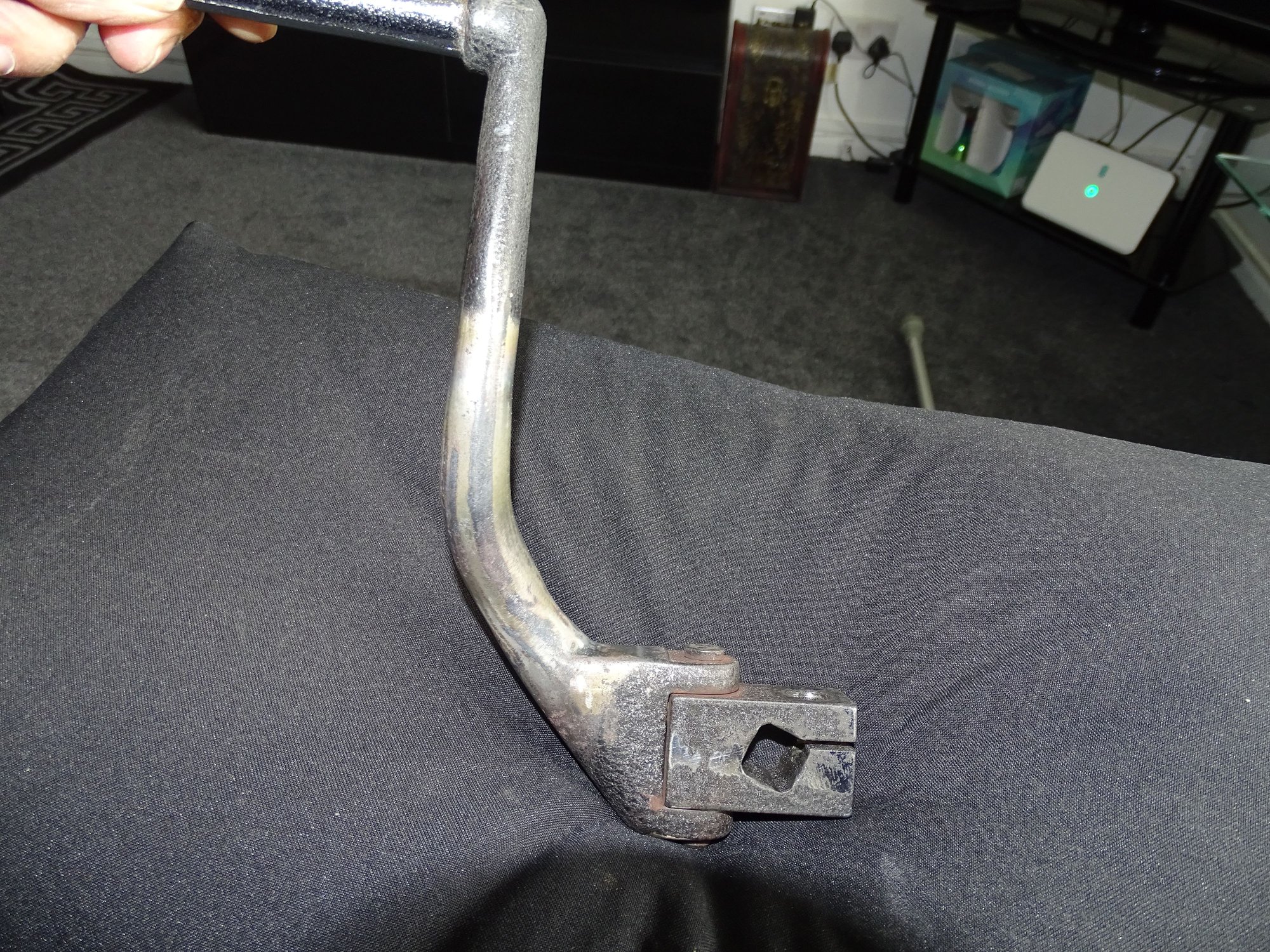

as no one here knew what the kicker was made from I went to Dave Batchlor of P&D customs in Slinfold West-Sussex UK with it, he told me they are Forged Steel not cast, and as such was easily bendable, he fired up his oxy acetaline there and then and in 10 minutes had a great 'S' bend in it bringing it inboard about 2 inches,
I ust tried it & it fits great and no longer prevents my leg fitting the forwards or when feet down at lights etc,
so remember for future information they are Forged, not cast steel & can be bent without cracking or snapping.
I need to strip the paint off and re-wrinkle black it & when done & fitted I'll post a picture, but heres a few as it is now
