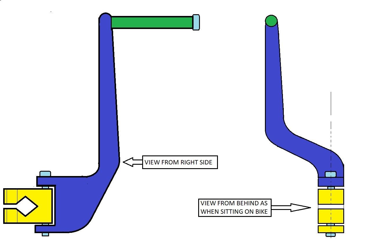

I need to put an 'S' bent in my swing out Shovelhead kickstart lever.
as I suffer from bad Hips & knees, i find that the stock position of the swing out type kicker gets in the way & is painful & awkward to put my right leg down at lights and when just sitting on the bike,
my idea is to put an 'S' bend in it starting just above the swing out portion going inward about 45* and then reverse the next bend so it goes straight up, but about 2'' closer to the bike, i know it will make the kicker slightly shorter and a bit further forward when folded out for use,but still able to clear the exhaust, which wont be the case if i were to bend a lollypop type non swing out kicker. but i can live with that.
well today I took it to a welders I know of to get them to heat it up with an oxy acetaline torch, then put the first bend inwards, & then to heat it again further up and put the second bend to bring it virtical again,
but the fella,
said that you cant heat & bend cast steel & not to bother,
is he correct or can they be bent with gas or is it a no no ?
has anyone here had a kicker altered with gas ?
This is a drawing of how I need it to look like after bending, is it doable ?

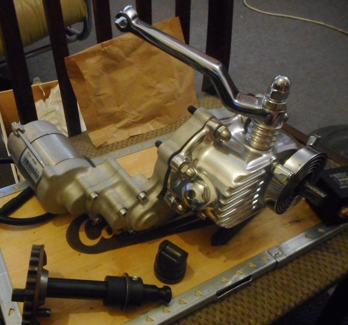

1/2 the reason the kicker gets in the way is that when you use the Cannonball starters you bring the kicker cover outboard about an inch more than stock as the drive unit sandwiches between the trans case & the kicker cover.
cannonball stealth starter
fitted to trans
without a kicker,looks unfinishd
with looks better & easier to time & set tappets but hits leg,..
