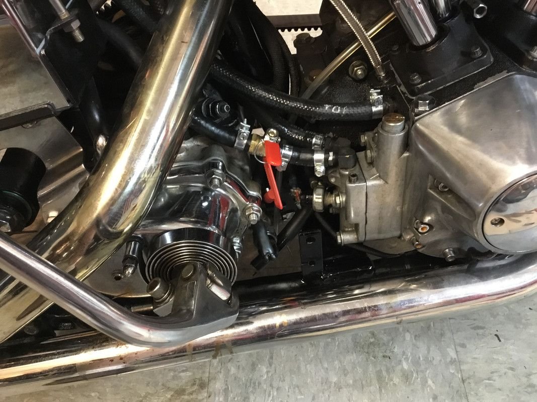

Got mine off a tool truck years ago but you can find them under fuel line clamps in a google search. Amazon has them.
https://www.amazon.com/Lisle-22850-H...002NYB78&psc=1
Thanks for the lead and link. I ordered a set. I was also one who used needle nosed vice grips to pinch off hoses.
Got the idea from an industrial item I used at the car plant the clamp off air lines when you couldn't shut down the main or some idiot didn't put in a shutoff to do line side repairs. They are a bit big for bike work.
