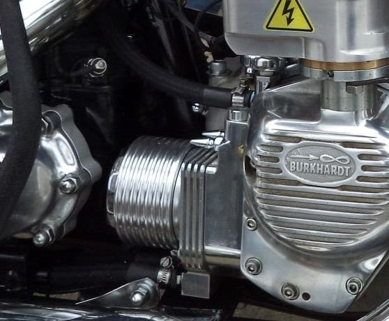

I never had any problems forgetting to turn the valve on since I have two of these flags; a small one on the valve and a large one on the handlebars.
I saw this posted before and it’s really practical, with the obvious caution. My oil system is completely configured as stock. This is slick.
Love the tags, I do similar things to remind me of the Stop-n-Lock in my rear shovel brake. Also when I use a front disc lock on my sporty.
