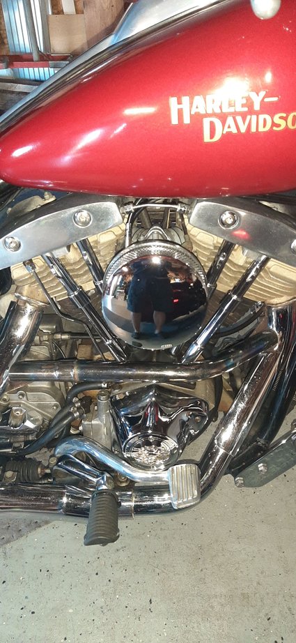

The old girl is up & running again.Rebuilt the carb & cleaned out the gas tank and took for a test run. Seems to run great.👍🤞I also replaced the clutch hub assembly. I pulled the primary cover off & noticed rivets by the magnetic drain plug.Removed clutch plates and disks & saw the clutch hub material had failed. I tried to video it running but the forum won't import it.

If you don't support that carb...Nothing but bad gonna follow. Sometimes a rigid moount can get away with that stuff...Never on any RubberGlide...they will throw the Carb right Off...
I sure would Like to see a Real Air Filter, on there...

Well bad news went about 10 miles & bike started missing & coughing,It died but started up again.I rode to a safe place & pulled over & let sit for 5 minutes.It started right up & made it the 7 mile home before acting up again.It seems to do it when its up to temperture.Racepress You mention about supporting the carb I was wondering where I could do that,maybe you could give me some insight.Also the dyno s is mentioned.Is this hard to install & time?I think I might be able to locate a E I box at Bills cycles if not I will check with you racepress.Appreciate all the help.I dont know much about shovels.Thanks
