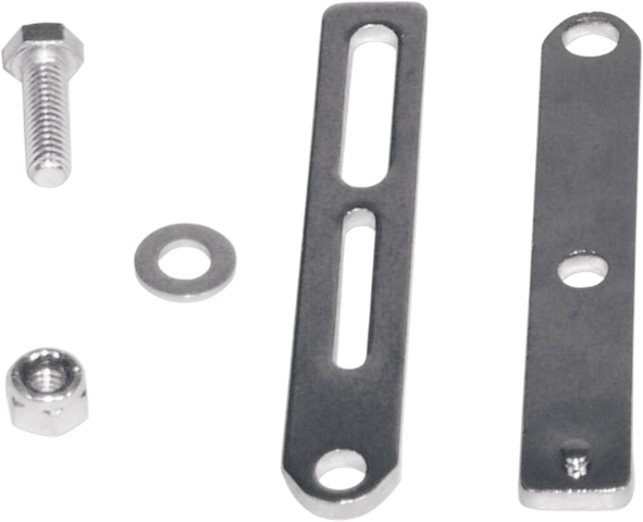

Later today I will dig out a Box, and get a photo of the Support I have here for an S&S, using a strap from the bottom corner of Rocker Box..... unless you go like this
Which I use alot also.. but Not with Spigot Carbs (CV etc) using this S&S Kit

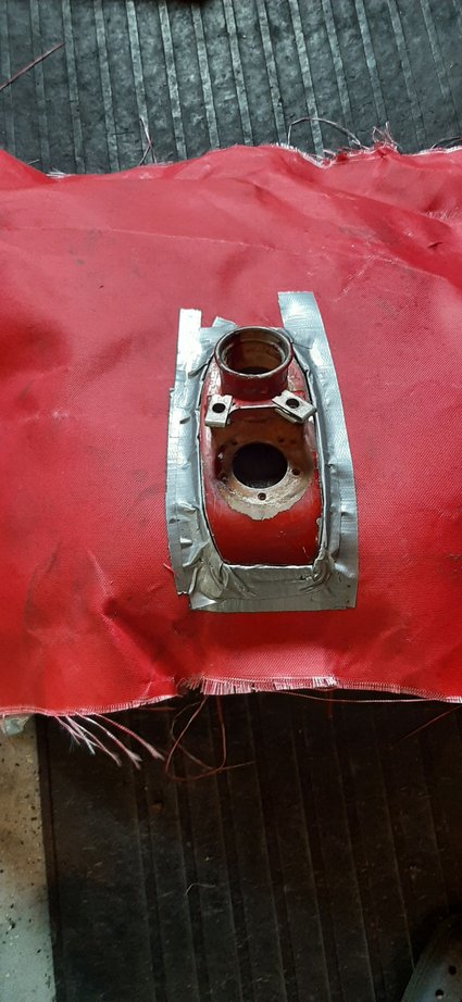

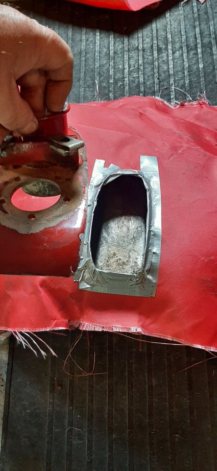

This is where I did some surgery on the tank.I cut the part under the console to peel the liner out.
This is what I removed.I went ahead and welded the tank back. All good not even noticeable.
Getting it ready for welding.
All back together & looking good.Maybe I didn't have to go this route but I just couldn't see getting it out without the surgery.I read about the acetone & various other ways but for me this was the easiest. Also when I was done I went with the electrolysis to clean any rust & actually it was clean.I don't know why they used the cream liner,maybe because he quit riding the bike & wanted to preserve the tank.I didn't put a liner in it,just filled it up with non ethonal gas for the Winter.Ran all the gas out of carb.
