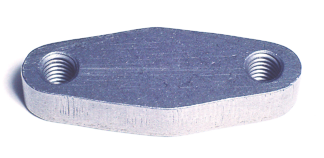

Want to put forward on my 1979 FXE shifter side of frame is fine. Brake side lacks the mounting block with the threaded holes to mount the brake. Has anyone ran into that I was told it was common on the 79 frame?

Common on some of the FX series frames with mid controls, they sell a premade tab that can be welded to the frame. You can make it or have made cheap. Added several over the years. Probably have one if you want dimensions. This is what the factory one looks like or most just use a bit of 3/4"x 1/2" thick bar stock.

Piece of 3/4" wide x 1/2" thick flat bar 2-3/4" long, bolt holes are 3/8-16 thread, 2" inch center to center, start the first hole 3/8" in from the end center of the bar. Looks like this.
You can use a bit wider bar if you want to grind to shape like the first picture. Trick is getting the angle correct and square to the frame and tacked on before welding, best to use the plate that bolts to it to get all right.
