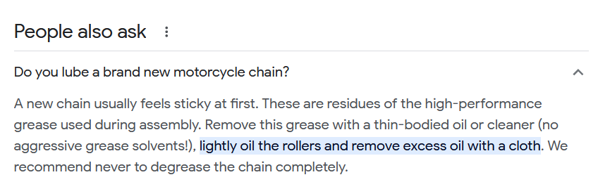

Found this with a Google search, there are a number articles.

I just pull the chain through a rag but I dont clean them with solvent. I see that film as a protectant. So far no catastrophic failures!

I do the same as "hellonewman". I just run the new chain thru a clean rag a few times and ride the bike.

Agreed, just wipe new chain with rag. So you are going to install a new chain and throw the other new chain in your saddlebag? Your new chain will be the most bulletproof thing on your bike, I can think of lots of other parts to carry on a trip other than another new chain, unless your sprockets are so worn that you don't trust a new chain.
