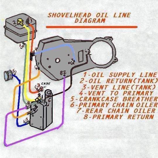

Don't know personally about your model bike but I can't imagine a fitting like an oil return being designed to be loose. The original shovelhead primarys were designed to be airtight which would allow oil to be scavenged back into the crankcase, a loose fitting would not allow that to function as designed. Here is a diagram that you might find useful
