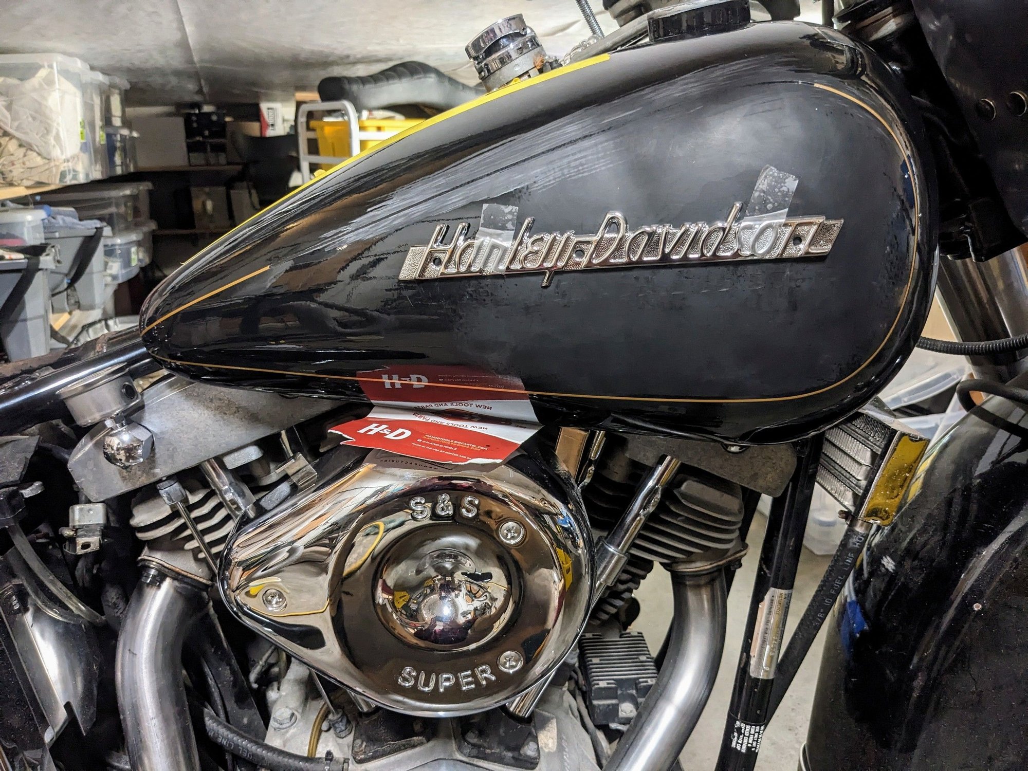

I have a 1984 FXEF that I put 5 gallon tanks on with an S&S Super E, with no clearance or stress issues by raising the tank in the rear slots. The "E" does not have a notched air filter and only the approx. 3/8" insulator block. It is a little tedious shimming the front bottom lugs on the tank is all, but it mounts stress free.

Whoa, that was an older pic showing the tank height; it has the carb support from the kit. Here is a more recent pic with the S&S support from the middle case bolt to the manifold. I never really had an issues with the other support bracket, but think the center one is a better option.

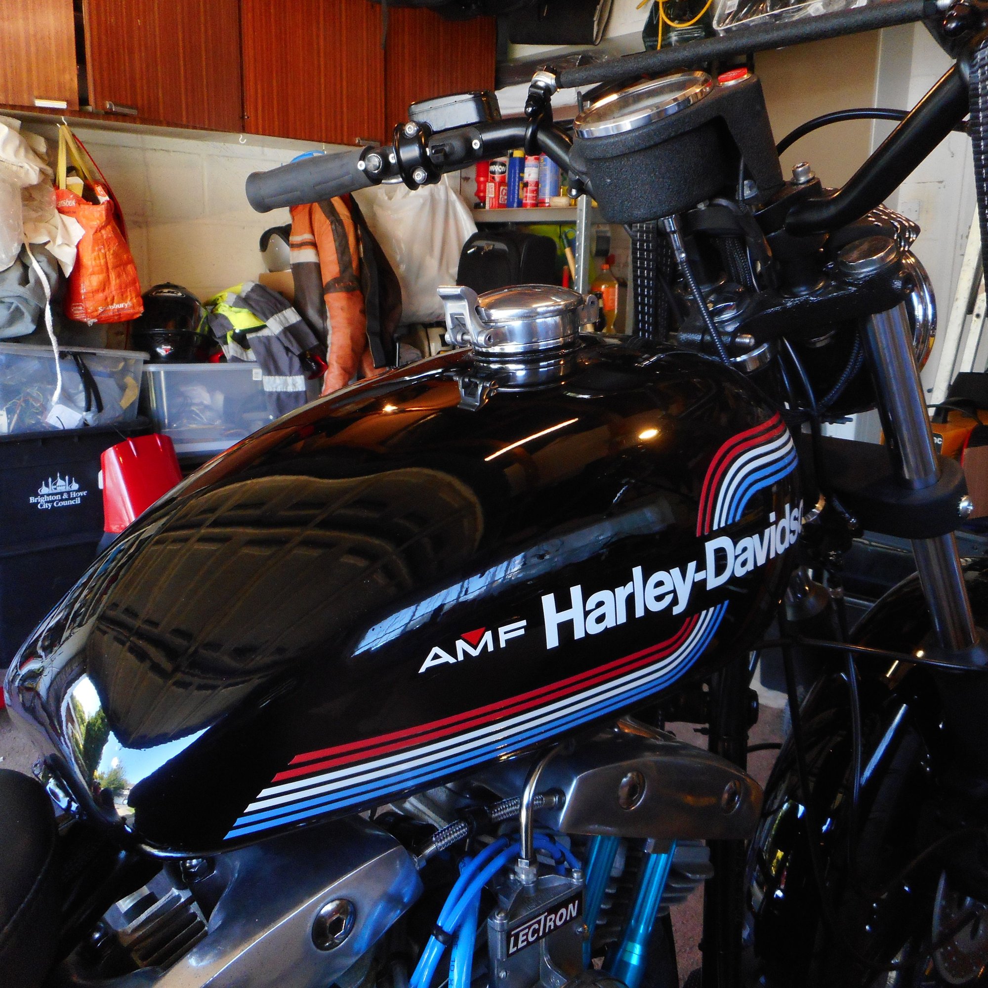

fit a Superglide 'peanut' tank, then no clearence issues or need to shim or cut anything...........and only 1/10 of a gallon smaller at 3.4 gallons instead of the 3.5 gallons of the smaller fatbobs.........
