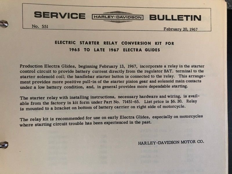

Yes..plastic, square..
^^ All E-Start Harleys "should" use a Starter relay...of some Kind.. the early Push Button (pre-1973) were robust...and certainly could handle the current to "fire", a Ford relay!! ( the above is Proof that originally, the MoCo thought that that button could bring in the Starter Solenoid alone!!)
I do Not trust the 1973 - 1982 start button to handle anything requiring more current than the Bosch relay.. Hell, The Replacement starter/horn buttons from???? IDK where...but ... East!! May Not handle the current to fire a Bosch relay!!!! I buy all the O.E. Handlebar controls and switches I see!!! Too many problems with **** from Offshore!!!
