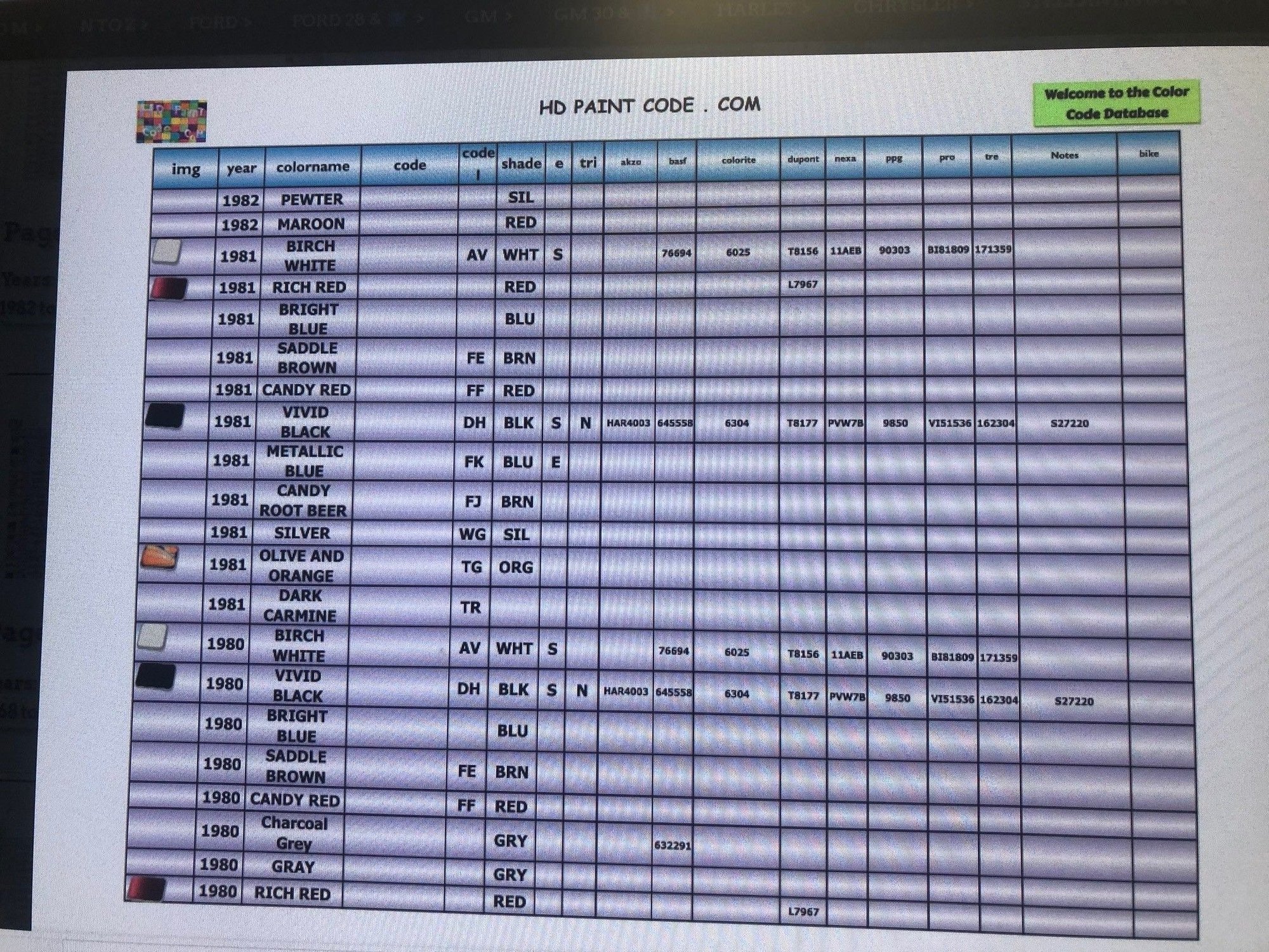

1. Is this blue color a standard 1982 FXS HD color? If not any idea what HD color it might be? I haven't been able to find another FXS with this color so I'm thinking it was resprayed at one point.

I'm not sure if that's the stock paint or not. The front fender isn't original so maybe it was re-painted at some time???

eighteight posted the 1982 color options (thank you sir!). One of them is Metallic Blue. That color option was also offered for 1978 FXE models. Here's a pic of that color (bike was stock except for the rear brake caliper which was from 1979))
Color looks similar as does the decal (sans the AMF logo). Not sure tho that the decal was used 1982 models.

Wow that's in great shape, grandpa will be proud to see you riding it! It could be a factory color, but maybe not stock on the FXS models? Call Harley Cares (customer service) located on Juneau Ave: 800 258 2464.
Give them your VIN and they'll tell you the original color and what colors were available that year. They'll also tell you when it was built and what dealer first sold it.
The 73-80 records are on Microfiche, but 81-up is available to them electronically, so easier to get.
1982 was the first non-AMF year so it won't have the AMF on the tank decal. It should also have a commemorative medallion on the front fender.
