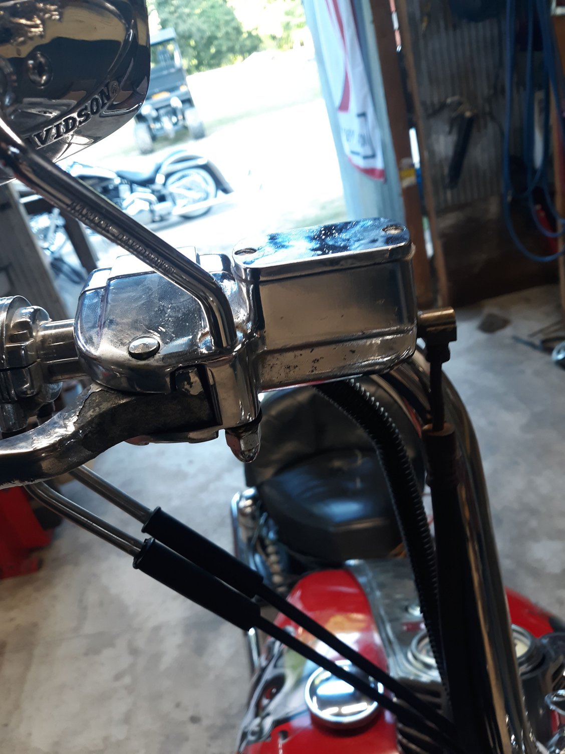

Also, I'm looking for a new front master cylinder because I have a leak.
2. Does this look like a standard 84 master cylinder?
Thanks guys

It looks like a standard but chrome M/C so could be aftermarket, My 84 Shovel is chain drive, no doubt somebody converted it at some point in the last 40 years.
Just because a bike left the factory with certain parts on, don't mean it still has them.

I have a 1984 FXEF with wet clutch (diaphragm) and rear chain. I do not think your master cylinder is original because of the chrome and also because of the brass fitting.
My master cylinder is black with a sight glass on the side and is scalloped to fit the handlebar curves. It also has a Banjo fitting and Bolt.

I believe my mechanic said something about the plunger inside the mc. I notice when i look up master cylinders its asking me the bore size, so I got to figure that out.

Sounds like it just needs to be rebuilt.
Also, like sbrmike said, banjo fitting and bolt.

Those handlebar controls are pre '82. The Moco switched the switch style (see what I did there).
