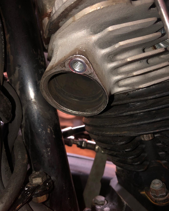

The real weak link I found on my Shovel would be the exhaust threads. Fixed mine once and for all with Time Sert. Has been holding up a few years now and several miles later with a Thunderheader
