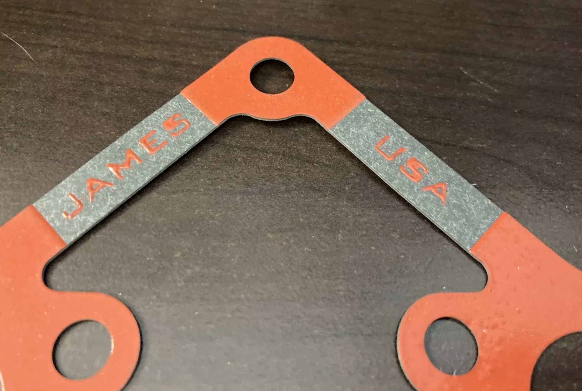

It is blowing out of the rocker box gasket pretty good! Rode it for two blocks and it was dripping oil on the pipe and creating lots of smoke. (Made me smile) This is the James gasket I picked up. So this gasket is not so good?

Since you already have the James kit I would use it. I cant say I have had any issues with James gaskets however I only use them maybe once a year. I would also say the rubbers on the rocker shaft plugs not leaking will soon be leaking. Simple enough to pull BOTH rocker boxes replace the shaft seals and box to head gaskets. Your top end kit may include the pushrod tube o rings and I would replace those as well just to be sure the oil is behind all new gaskets and seals.
Those are straight up trash, be leaking again in couple years tops, you want the metal/silicon/wafer style gaskets for a one and done.
