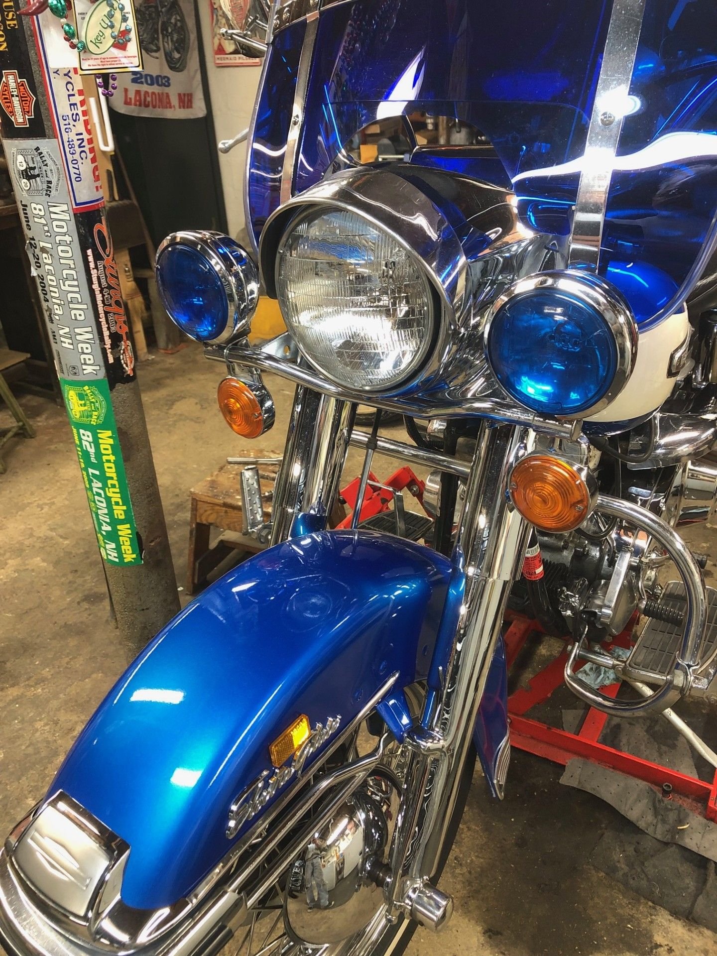

Blue cop magnet lights

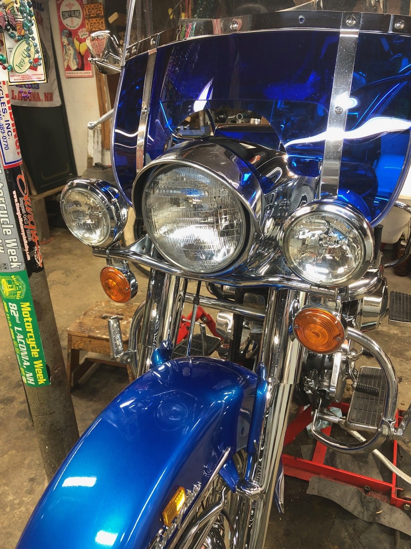

Clear for better night time visibility. After this picture I also adjusted the blue window down closer to the nacelle, that gap was making me crazy.
