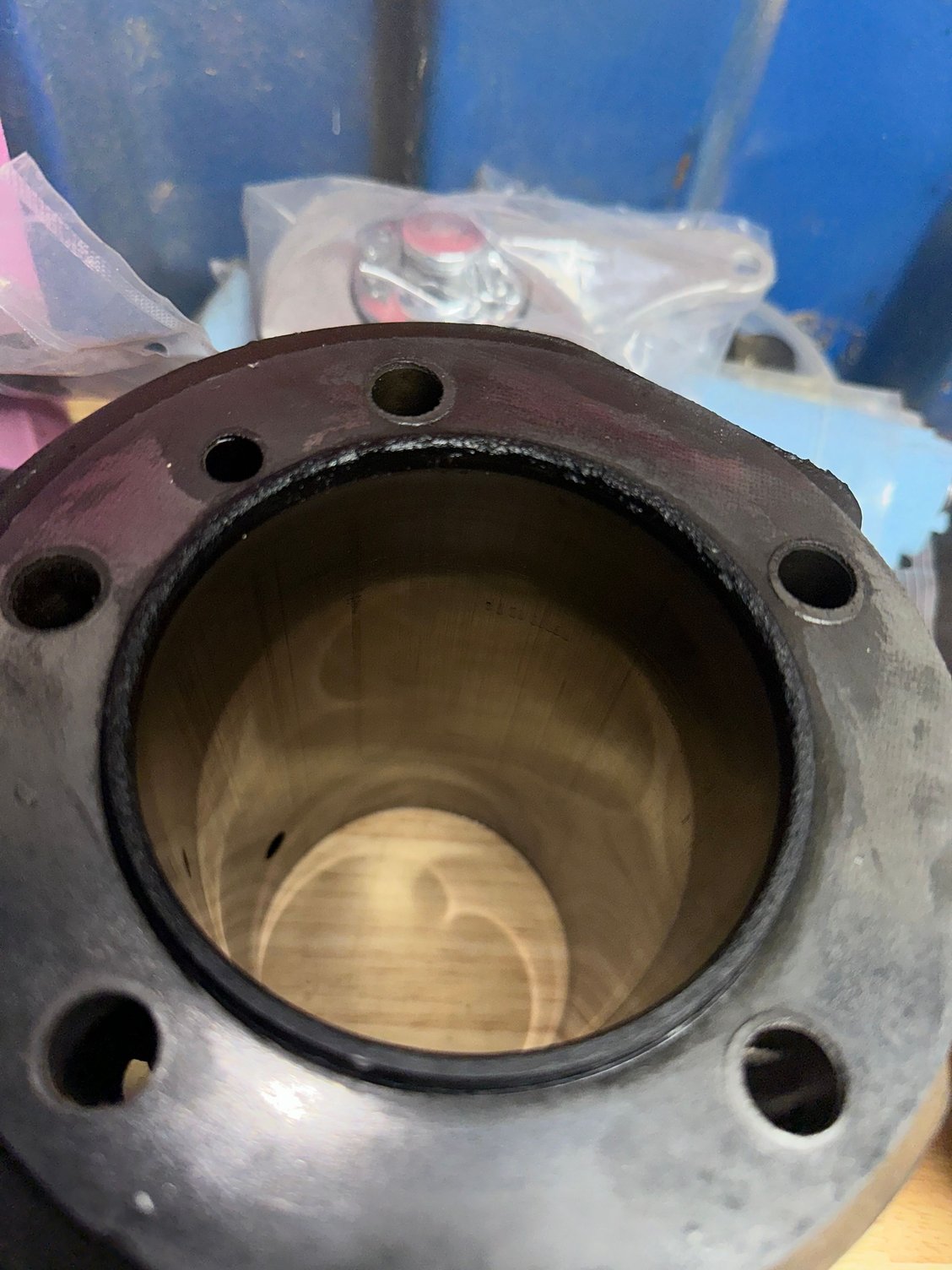

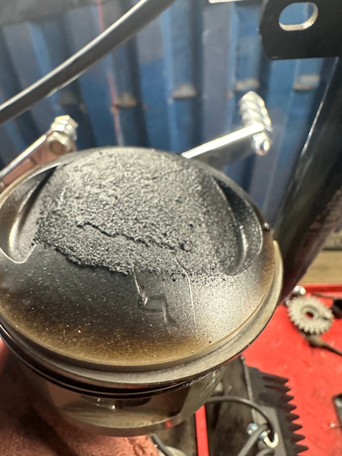

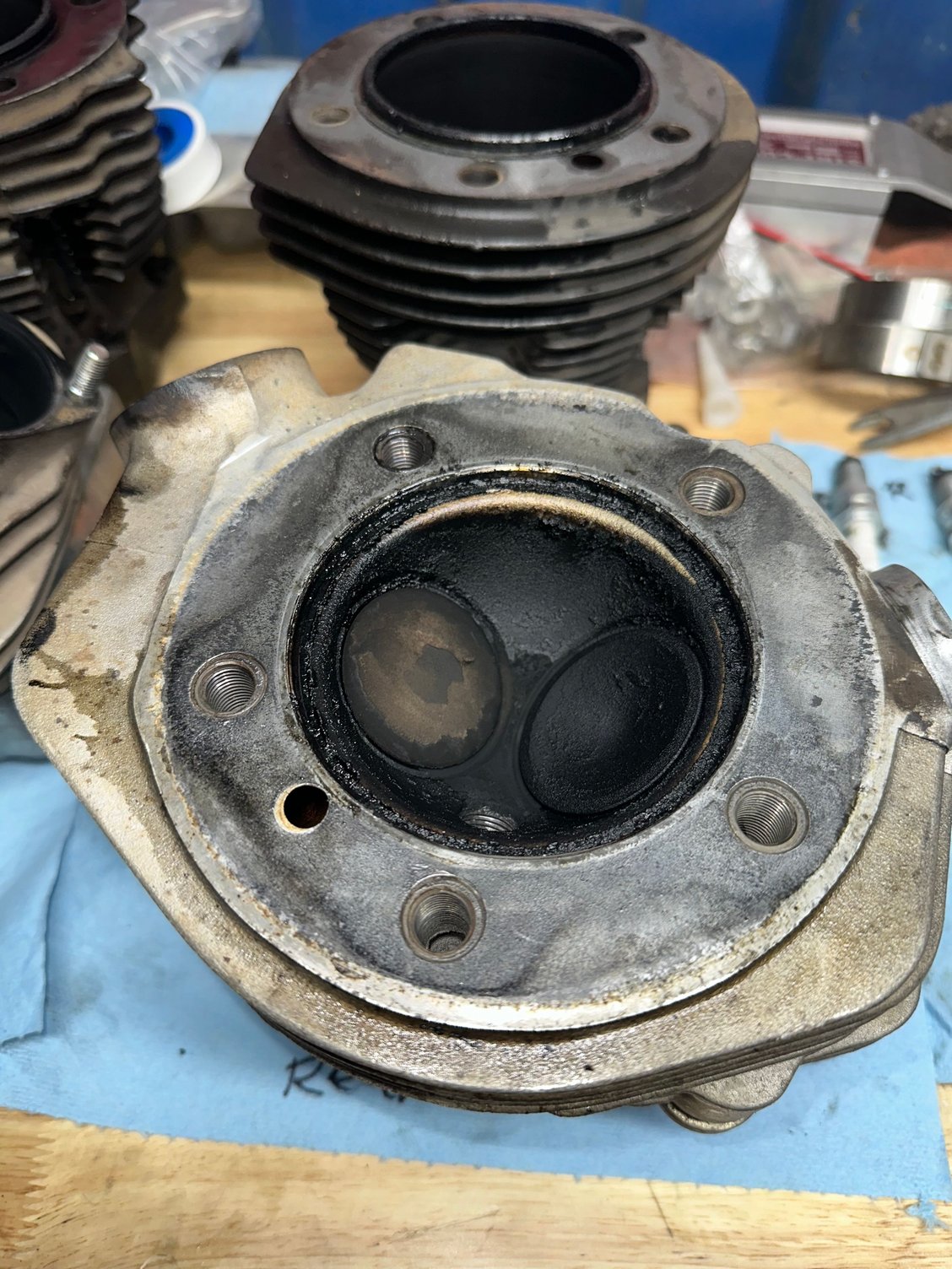

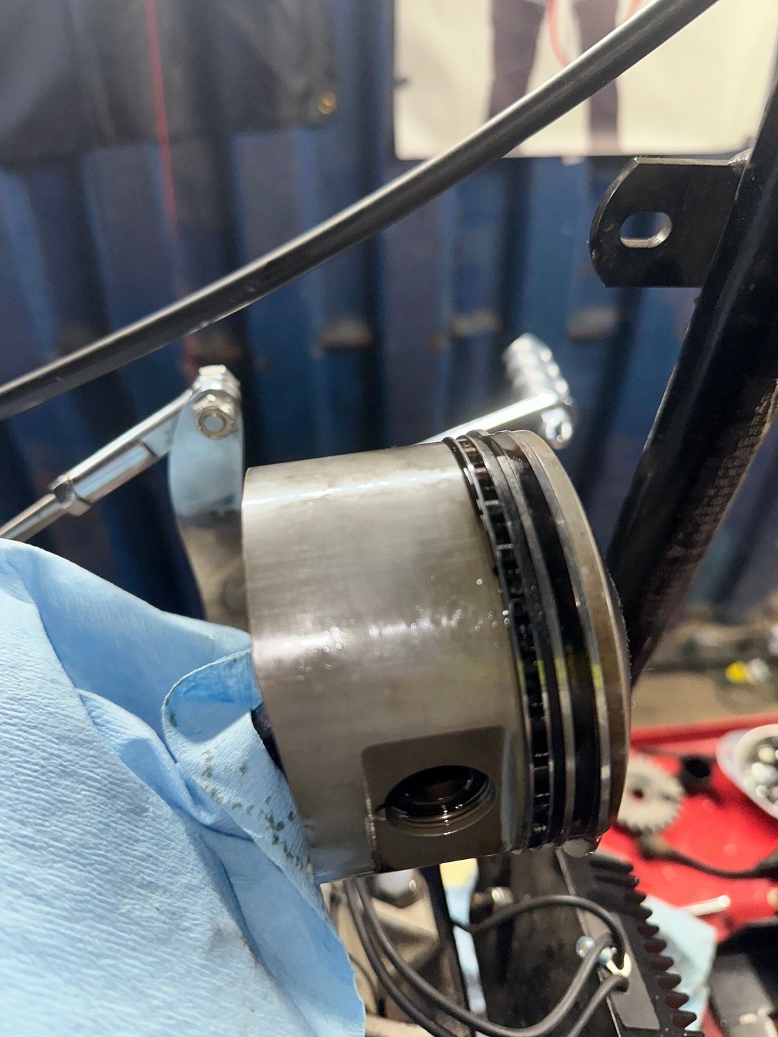

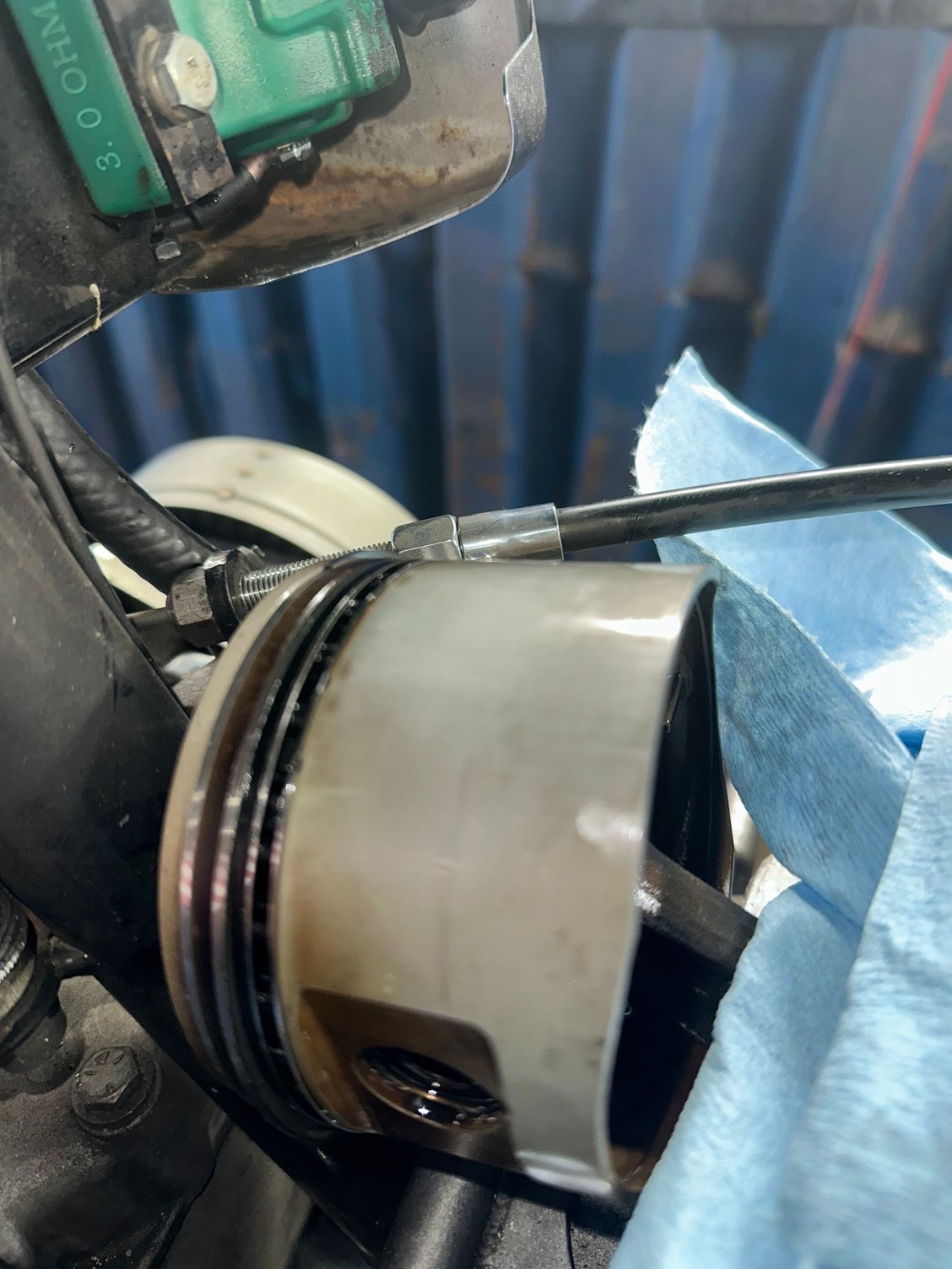

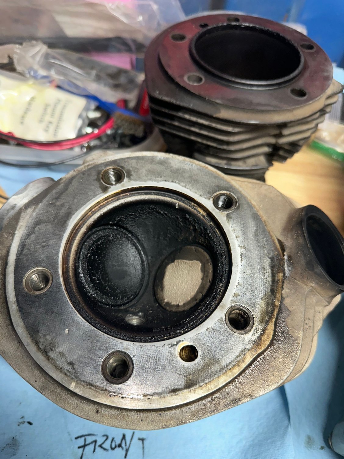

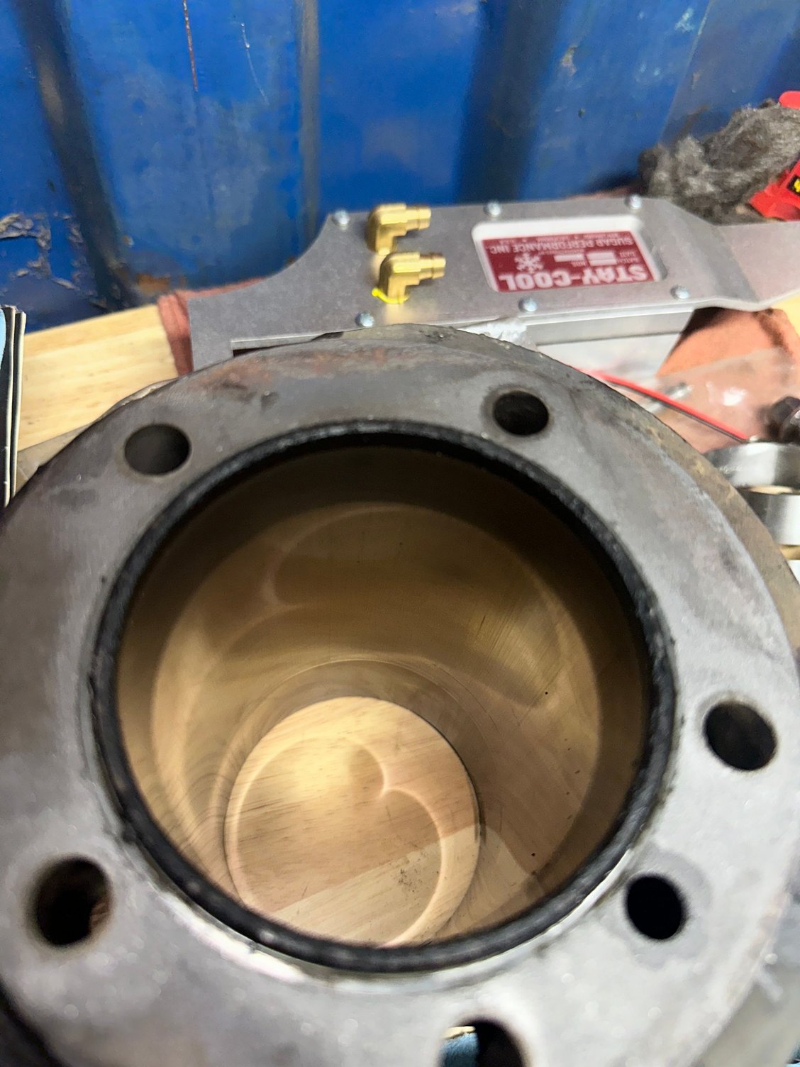

Noticed a leak at the front cylinder last Sunday. Decided to tear down the top end today - found out previous owner didn't even have a gasket between the front cylinder and head which explains the leak. Was relieved it wasn't something serious. I have been burning oil since I bought it 3 years ago so decided to do some investigating. Thought maybe just needed new rings but the pistons look good (I think) and the cylinders look great. What do you think is causing my oil burn from the pics? Maybe valve job? This is my first time tearing down a motor like this - all input is appreciated!

Based on the pics I would redo the top end. The marks in the bore, its shiny with no crosshatching and if there was no head gasket I would be shocked if they guy put guide seals on it.

I ran many years an iron head pro gas race bike with no head gasket BUT we used red loc tite for the iron head to iron jug for sealing
have a hachine shop do both as said and use the rubber valve stem seals not the tin china copy’s today
The more I looked at it the more you're right. There was no more cross hatching with mainly vertical scoring.
I have a guy lined up already for a top end rebuild. Gonna take it in next weekend.
Stupid question but I obviously the fix will take care of burning oil but what kind of performance improvements can I expect on a fresh top end?

I hear ya but the head came loose with MINIMAL effort. He didn't run anything between the head and cylinder. I'm surprised it took this long to start leaking to be honest.

You would see a bigger gain with a cam change than a top end refresh if it was running okay other than oil consumption. Im sure you'll feel it but you wont be blown away by the improvement.

I may be wrong, but it looks like a gasket is on it get a screwdriver see if one is on that
​​​​​​​There was a gasket on the rear jug - nothing on the front jug.
