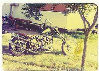

Just for grins.... a picture of my first Harley. I built it in 1965. it's a '48 panhead 80ci via flat head 80" wheels, Sifton cam and a bored-out Linkert
48 pan, 80
'48 pan, 80" flat head wheels, Sifton cam, bored out Linkert carb, sportster front end, 1/4 rake

Dude, extra points for the picture of a polaroid! Adds to the authenticity.
