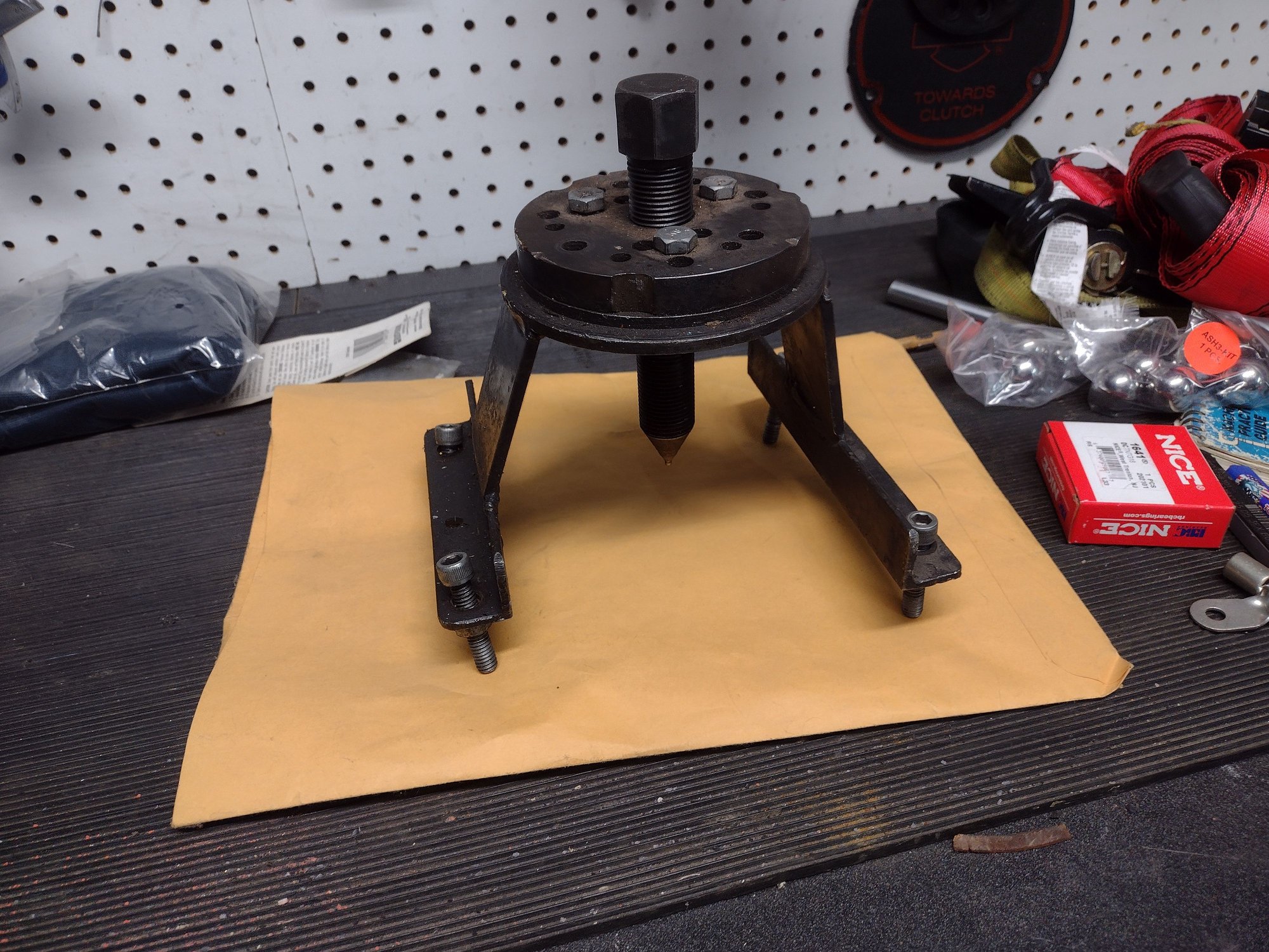

Easy to make a tool to pull that bearing into place. Find an old comp nut, cut the head off, weld some 3/4" all thread on and about 6 or 8" of 1-1/2" pipe, even PVC will work. I just heat the outer bearing some and they usually drop right in with a little gentle tapping with a drift. You really do not want to do any pressing or wedging with the flywheels.
Made this decades ago to push them apart.

^^^ I love the Multi Use Puller...Gonna copy!!!
