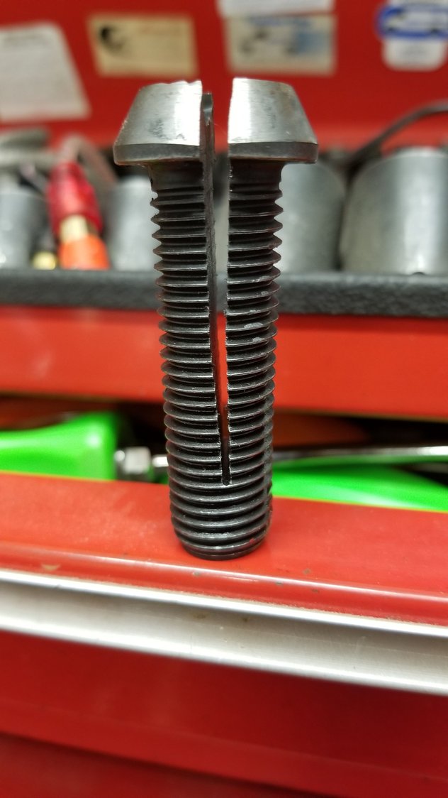

I made a puller out of a 16mm allen head bolt. I ground the head back on an angle and cut it down the middle. It worked perfectly.

I got a takoff wheel that didn't have the abs sensor side bearing.
that said... the ole anchor bolt worked like a charm.
thanks to all for your suggestions.
