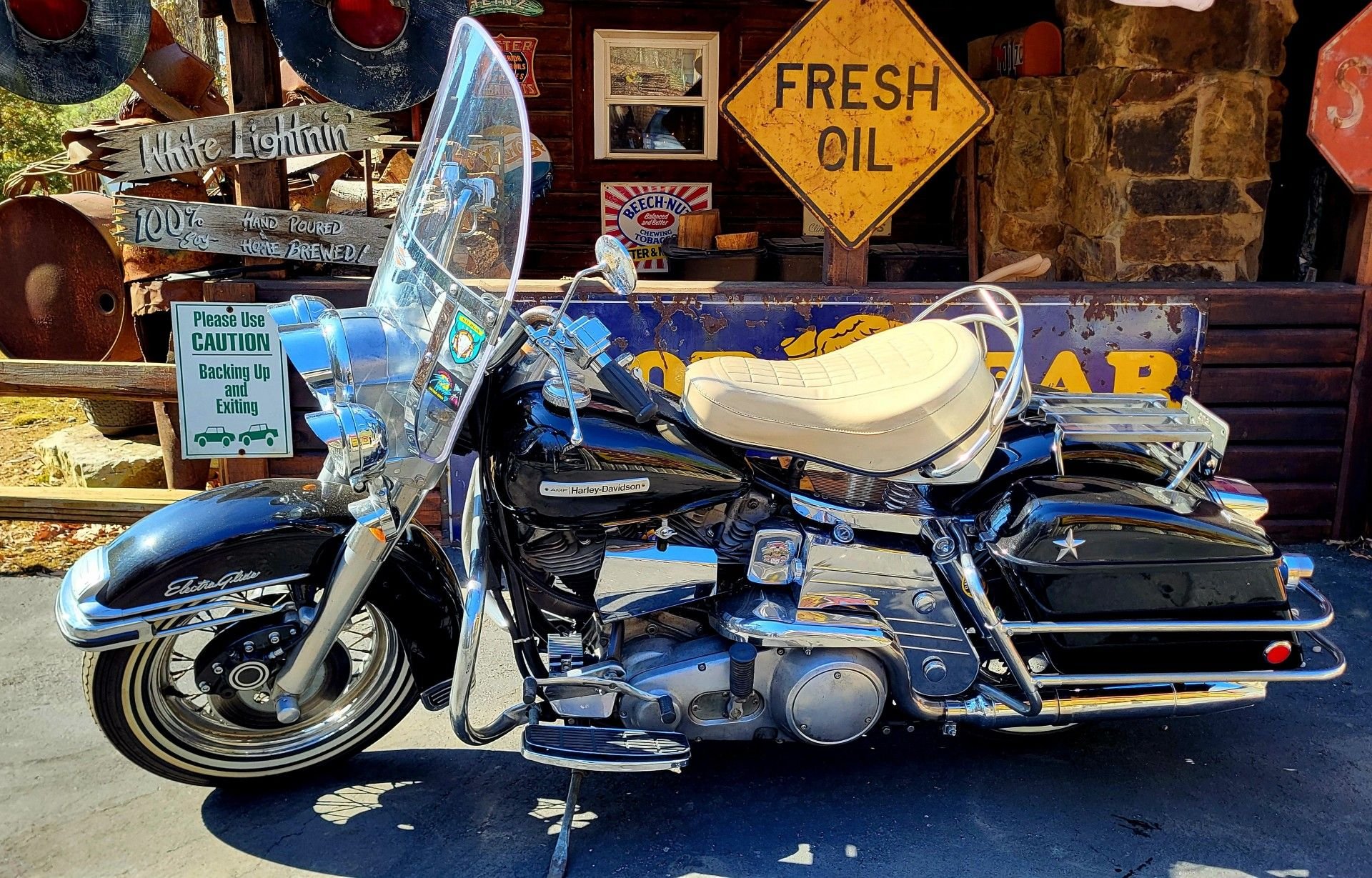

Hi guys....I need some help.. A little background first. I've been "messing" with 74's since my '48 Pan when I was a teen. Back in '73 I was a motor officer on a '73 Electra Glide. Needless to say, I'm getting on in years. I have a full race FXDR and my old outlaw bike. With all that said, I met a guy at Sturgis in '96, and he had a '73 police issue Electra Glide. it was "crusty" but very well kept. I finally acquired it in December '24. It's now part of my stable of V twins. I am 90% finished with it ........I am restoring it to exactly the way Harley sold it as a police bike.
I guess you could call it my "bucket bike"! I beat cancer.... but have heart failure.
I finally got to the point it needed to be test fired.....the base motor and tranny needed no work at all....only the rest of her! Last couple of years it was not driven except the occasional down the road and back by its old owner.
Now for the problem....I adjusted the clutch, SO after it's warmed up and I put it in gear.... holding the brake, simulating a stop sign, the clutch is "grabby". If you stand still long enough (like a traffic light) with the motor idling it will stall..
Tomorrow, I plan on adjusting the clutch another 1/2 turn to maybe a full turn and see what happens.
If nothing improves.... maybe a new set of discs?????
Any ideas??????
BTW: It's really nice now, this is a "before" pic. I'll post a pic ounce it's completely finished. BTW: ALL the dresser stuff will be for sale at bargain basement price, once I'm done, including the Harley buddy seat.
My 73 Electra Glide as I got it, most of the stuff has been stripped and replaced with original HD police items as it was new!
My '73 Electra Glide as I got it, most of the stuff has been stripped and replaced with original HD police items as it was new!
