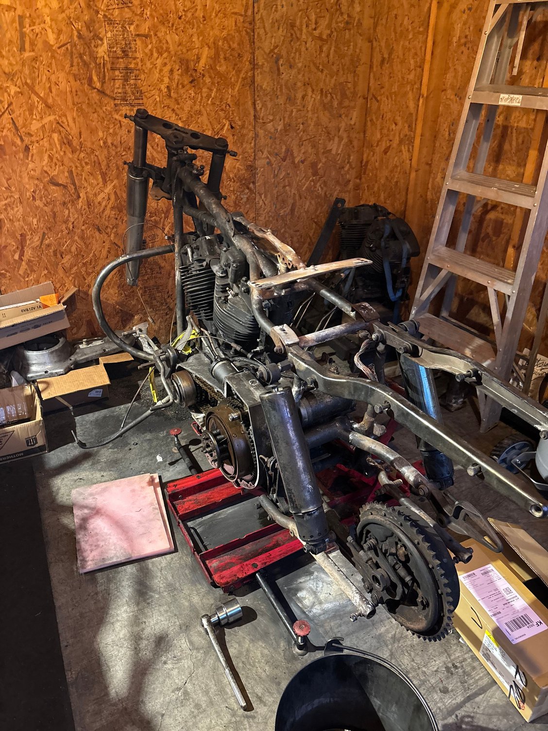

Got the Kroil smells strong, does better because I could finally break loose the hand spiral throttle.
Cleaned all the drippings, turns over with compression and pumps oil out.

I mocked up the motor enough to crank it and it fired but not run the carburetor is iffy, without exhaust on it I see oil pressure taking and returning and is making it up to the rocker boxes oil leaking underneath fitting there as it’s running down the oil line, tightened it, but still wants to leak and
oil out of all four rocker shaft screws if those O rings bad can I get to those from the outside?
And the pushrod tube O-rings are all bad. Should oil still be spitting out of the lifters without the O-rings in there as I have the covers held up if is there o rings around the lifters?

You gotta give me some slack here no oil coming out into the primary case or the timing house, it’s a 94” Ultima 1000 miles on it. So far I think I’ll get by with those rocker box O-rings and lifter push tube seals. Some healthy signs of this motor so far.

You can't replace the pushrod tubes without removing the pushrods. You knew that, but I don't understand your question.
Short pieces of rubber vacuum hose make better seals for the oil supply fittings than the too-short ones in the 'kit'.

The hardline running up to the rocker box that’s where it’s leaking out of up there. Is that what you mean? So damn busy with other things I haven’t had a chance to explore that hardline yet. I’m wondering about the tube O-rings would they prevent the lifter oil pressure from coming out? Oil spray cranking it over. Appreciate your experience on the motor.
