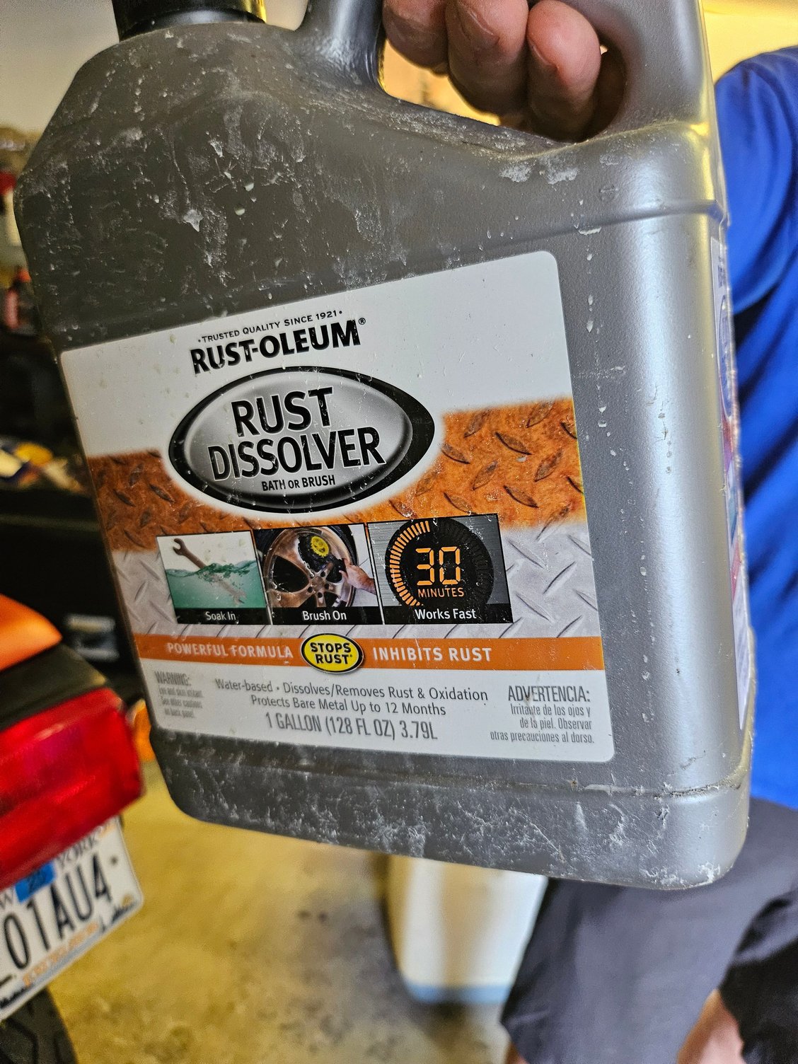

I don't know how it affects paint if you spill it, but this stuff works amazing on removing rust. Leaves metal like new.

Doing a chem soak with the rust remover does it nice, reuseable to which is nice it ain't cheap. If the paint isn't a major show stopper and you need to stay on top this while in process. Plug things and 50/50 mix muriatic acid and water, but you have any thin spots it'll find them.
