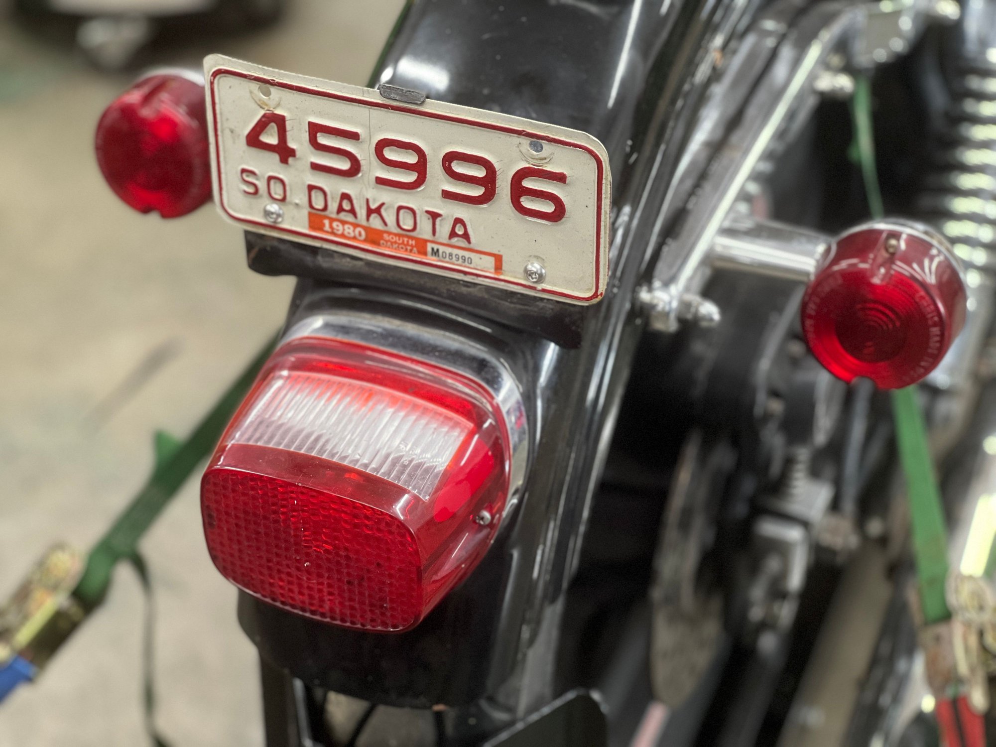

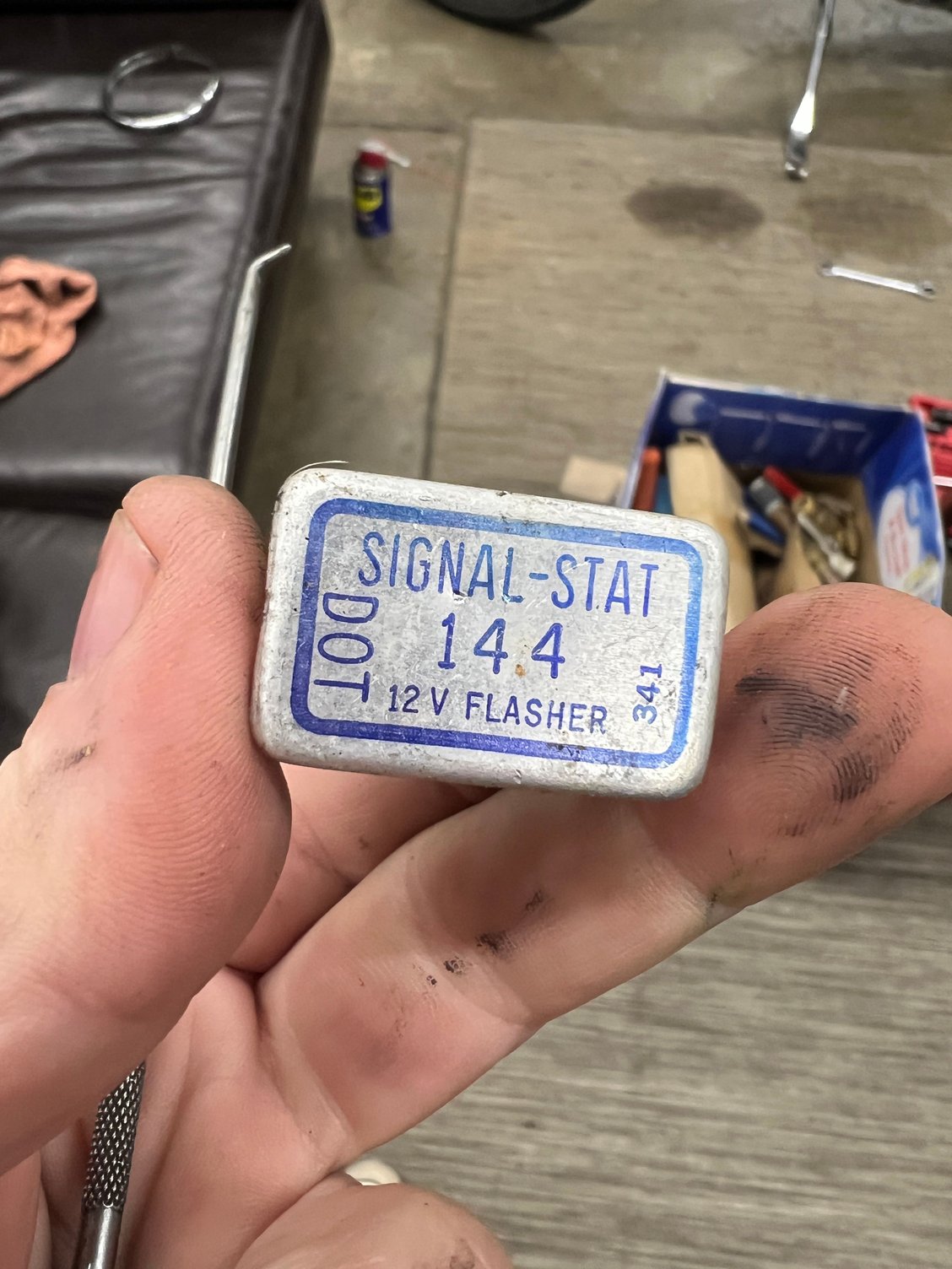

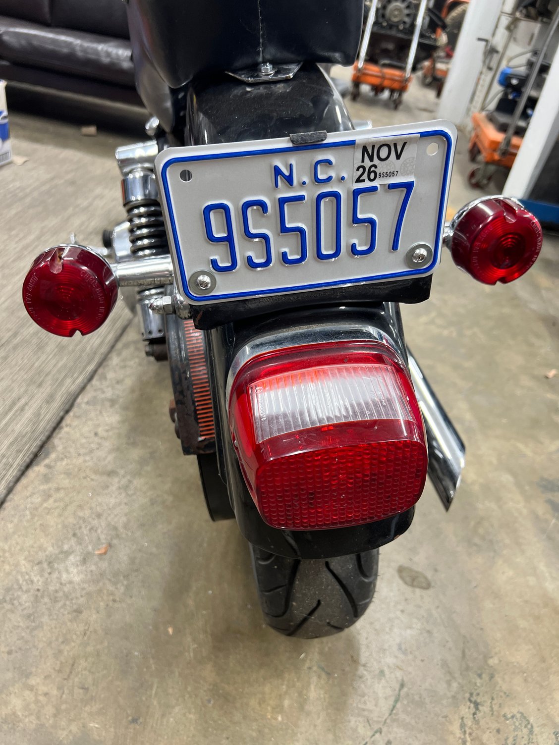

These are the incorrect signals on the rear - they are newer 2-wire signals, with red lenses because they work as brake & tail lights via an aftermarket module that I found under the seat. I don't hate that idea, especially now that I have the system working correctly (needed a flasher relay), but since this bike is ultimately to be restored, I'll probably move these to my Ironhead project when I find original replacements.

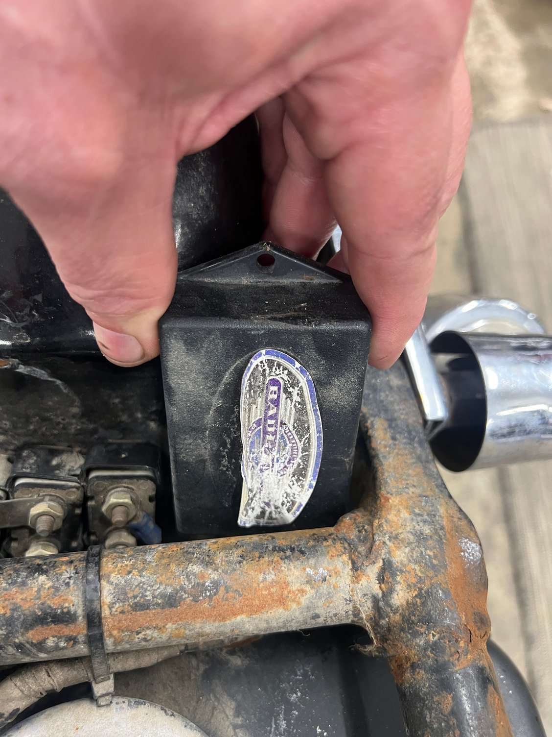

You can see the incorrect brake light lens here as well (should have a clear panel where the ribbed area is, like my Ironhead has). I stole the rectangular flasher relay from the Ironhead to fix the Sturgis, and will need to buy some reproductions to have on hand (the larger round relays don't fit in the factory holder in the headlamp).

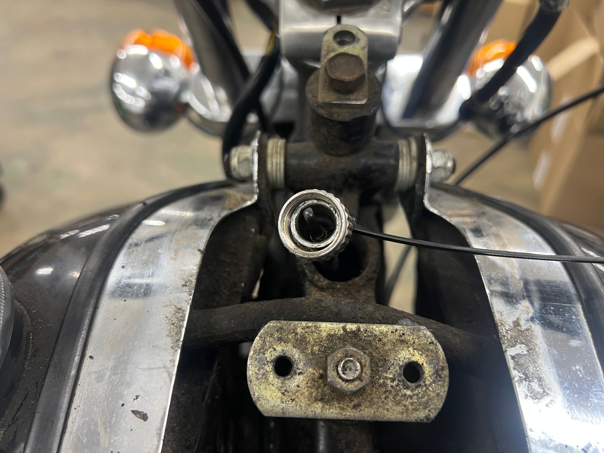

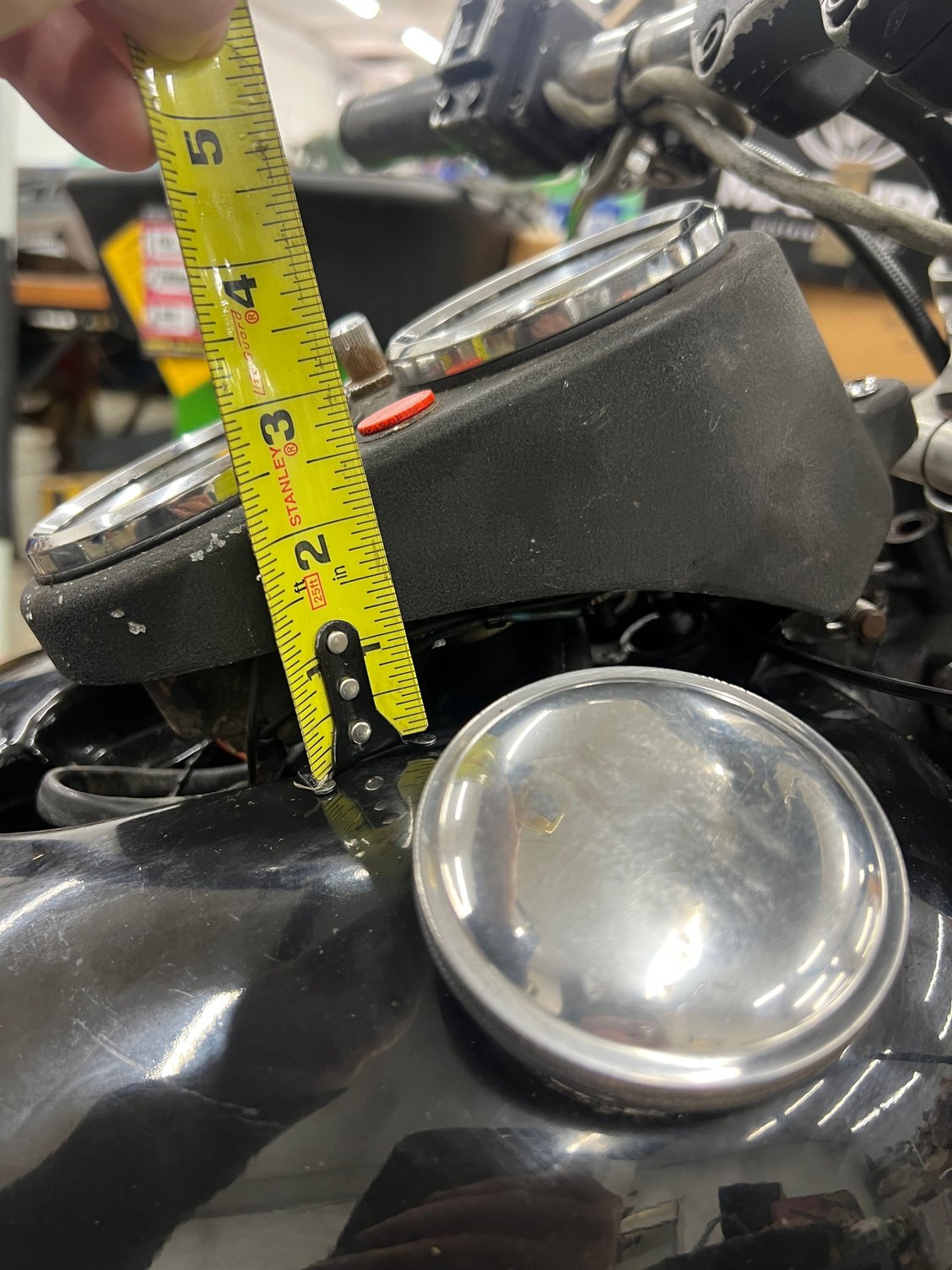

When I decided to correct the dash fitment, it looked like this:
After a bunch of head scratching and feedback from the FB group, I started measuring to eliminate any weird mounting/gaps between the frame and dash
The first measurement is correct, the second is way off.

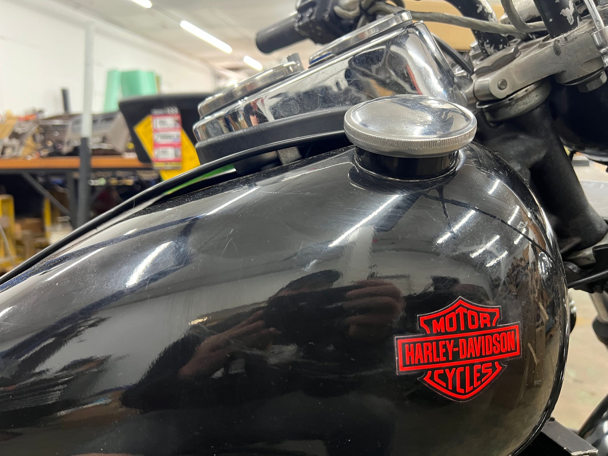

Also, the tanks are shimmed absurdly - but the real evidence was the crossover line nipples at the bottom of the tanks - the factory has a 90 degree bend, these are straight down. Chinese tanks, I'm guessing.
I have a line on a pair of factory (not FXB) tanks for a good price, so it's getting tanks. In the meantime, I'm just running ugly without the trim piece.

why does it need all those tank spacers
Old Nov 21, 2025 | 03:50 PM
  #35
Racepres's Avatar
Racepres
Posts: 8,607
Likes: 3,375
From: Cental, MI
Whatever it Takes to Not put any strain on Tank Tabs...they fail soon enough.. Besides visually lining **** up!!
Edit; BTW, I take a wrap of electrical tape around those "stacks"... Instant Spacer!!!

Is that tank B&S just a sticker?
Old Nov 22, 2025 | 08:14 AM
  #37
eimkeith's Avatar
eimkeith
Joined: Mar 2024
Posts: 61
Likes: 33
From: NC
yes.
