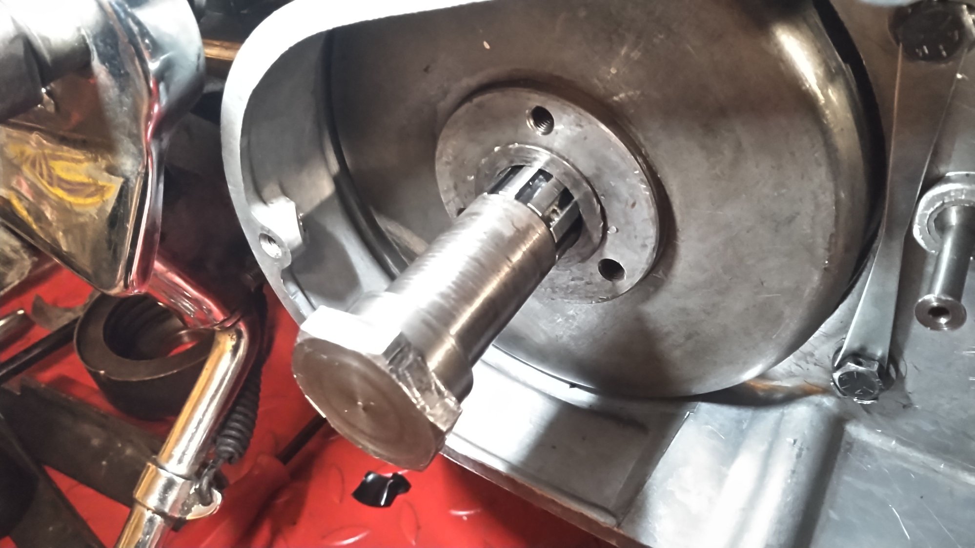

Just a quick tip from another long thread, maybe save someone some time
When I cleaned the threads to install the compensator on a shovelhead, I did not clean them enough and the nut torqued before it was fully seated.
So I took the nut out of the compensator. used a bit of heat and cleaned then again, then used the sprocket shaft to chase the threads gently a few times until I could confirm the nut will seat fully. Im sure a lot of wrenchers know this but slow learners like me can always use a tip.
Hope someone finds it saves them time.
