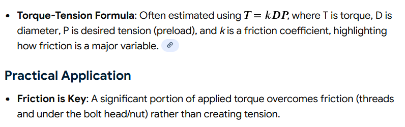

Well now this is getting confusing. Found this tid bit on line and the formula shows that friction is a factor. So I would think that even loc-tite is a lubricant. The car I put the wheels on was brand new and the studs and lug nuts were absolutely dry. The lug nuts have a teflon coating on the taper where they contact the aluminum wheel so that is lubricated. That is how GM did it. I thought I had the right train of thought, but now I do not know.

FWIW, in engineering terms, there is running torque from thread friction, and applied torque which is anything above running torque.
