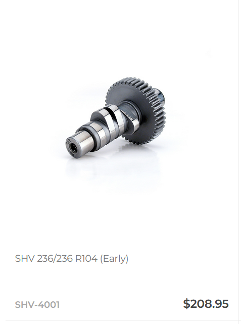

I looked up the Vtunder SHV-4001 and it is listed for earlier shovel, up to 1977. Then they have cams listed for late shovels, '78-'84 but not with the specs of the SHV-4001. I would think with different specs it is more than just the cam gear.
Specs are the same 70 to 84 on any cam, the part number split is the early or late gear on it. You are WAY overthinking a lot of this stuff and confusing yourself in the process.

As @TwiZted Biker said above, the later cam has a different cam gear, the cam is the same otherwise. The late gear can be identified by the ring on the outer surface of the cam gear. Which cam be pressed off and replaced with the original or at least one with the correct tooth pitch to match the drive gear on the pinion shaft (also changed on later models).
I do not think I am over thinking in this case, going to their site I do not see a late version of this cam like I said above. Other grinds I see early and late. If you see a late version on this cam show me and I will eat crow.
https://www.compcams.com/products/co...-davidson.html
Paul
Thanks Paul, I all ready knew this. LIKE I SAID ABOVE Looks to me that comp cams does not sell a late version of the SHV 4001. Could I buy that cam and change the gear? Probably but I am not going to pay for a cam with the wrong gear for my application.
