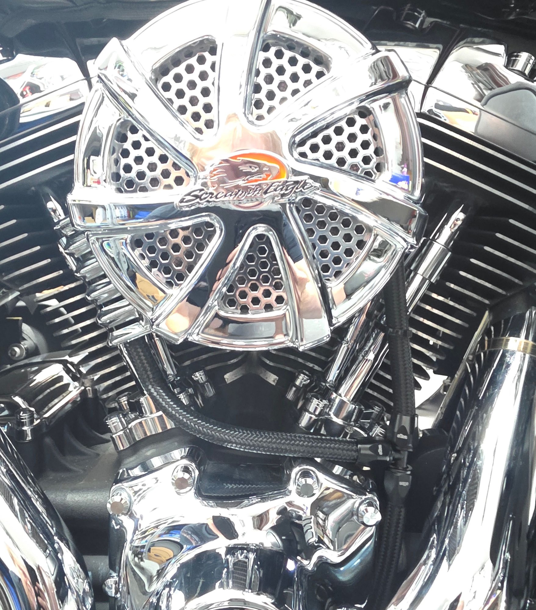

I have used the DK Customs DIY Catch Can External Breather System (2015 FLHTK). Installed in 2020 at 10k miles, when I changed the oem air filter to the Screaming Eagle Air Cleaner (29400064). DK Customs even supplies the proper drill bit in order to drill and tap my new (expensive) air cleaner, and install hoses that divert the mist into a catch can. I've attached a photo of where the catch can is located. Plenty of videos can be found on how to do the procedure.
It actually works very well, and I recommend doing it. But! Yes, but, one thing you need to make sure of, and that's to routinely check and clean the little catch can.
Last year (25k miles, 2025) I somehow totally forgot to check the can and clean it out. What a mess. Catch can got full and it all backed up in the lines and made a huge nasty mess inside my throttle body, a lot worse than before I done the bypass.
So I cleaned it all up, and decided to replace the breather assemblies (which at 25k miles it was due anyway) and also do the rocker support plate modification by drilling .125" drain holes.
After cleaning, I definetly noticed a huge difference in performance, evidently the sluggishness I never noticed probably because of the slow progression of buildup in the throttle body after the catch can got full.
So I decided to eliminate the catch can out of the modification, which I read you're unable to do, but like I said, be sure to check and clean that little can often, very often. Right now I do not have the catch can installed, I eliminated that and it just vents to atmosphere. The lines are ran down towards the front and then along the right frame rail and it ends underneath to the right of the path of my rear tire. But after repeated examination of the end I have no oily residue anywhere, not even a drip after parking. I think drilling the 1/8" holes (and new breather assemblies) all but eliminated any breather mist. There is a noticeable air flow at the end of the line so I know it's working.
Catch Can circled
Catch Can circled
No Catch Can, vent to atmosphere
