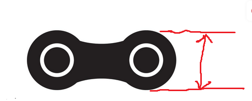

Would the o ring or x chain be wider in this dimension than the standard chain aiding in rubbing the inner primary. I have the O ring chain but an wondering what the dimension of the standard chain is. Can someone give me a number?

from the interweb......on a 530 non o-ring chain plate height = 15.1mm......pin length max = 22.5mm and measuring mine its spot on..........i use the rear chain oiler because on my flh with bags and that big chain guard its difficult to get at the chain with a can of chain oil............. i get about 5000 - 6000 miles out of a chain then it needs replacing
