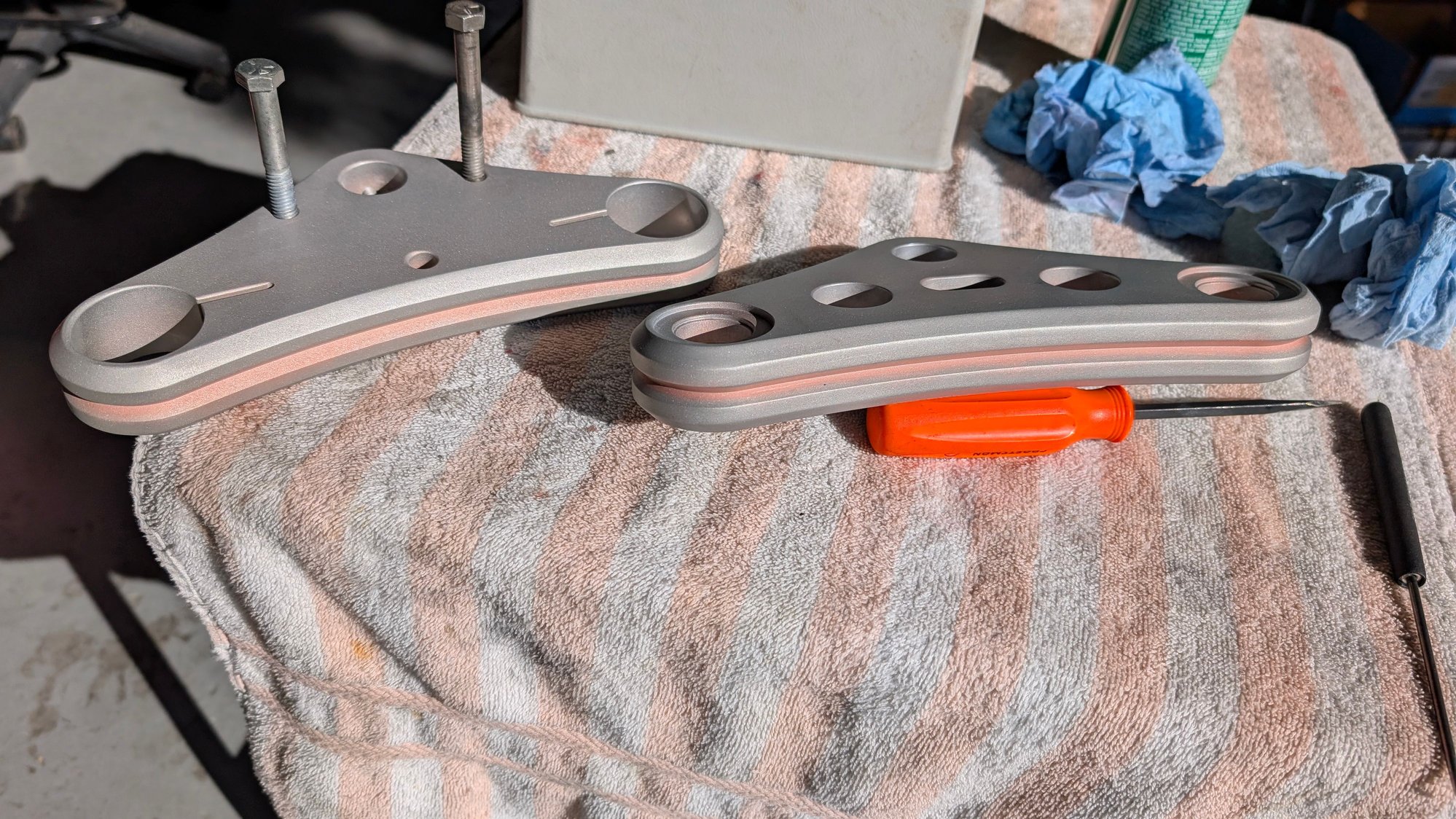

Armpit deep in complete redo of a 79 shovel into the owners dream bike, total brass ***** / steampunk motif. Going for zero chrome but little to no paint if we can get away from it. Firgured out how to friction plate brass to steel & stainless without killing the temper on hardware and off we went. Bike was badly abused before he got it so it's been a naked frame up deal, we've had to pull everything down and lots of rework.
Just a taste of how things are coming along.
Was a new set of very chromed midglide trees for 41mm tubes, Narrow glide measurements but uses 41mm tubes & legs for better brake caliper mounts, getting dual Wilwood calipers and cartridge internals from Progressive. Handling & brakes were driving the guy crazy coming into a shovel off high end dual sport bikes.
Got around the shiny by using tired glass bead media to dull the chrome and just bring out the copper where chrome doesn't plate well like grooves or sharp corners. Hit it with a flat high heat clear coat to seal things and it's working well so far. More to come.
