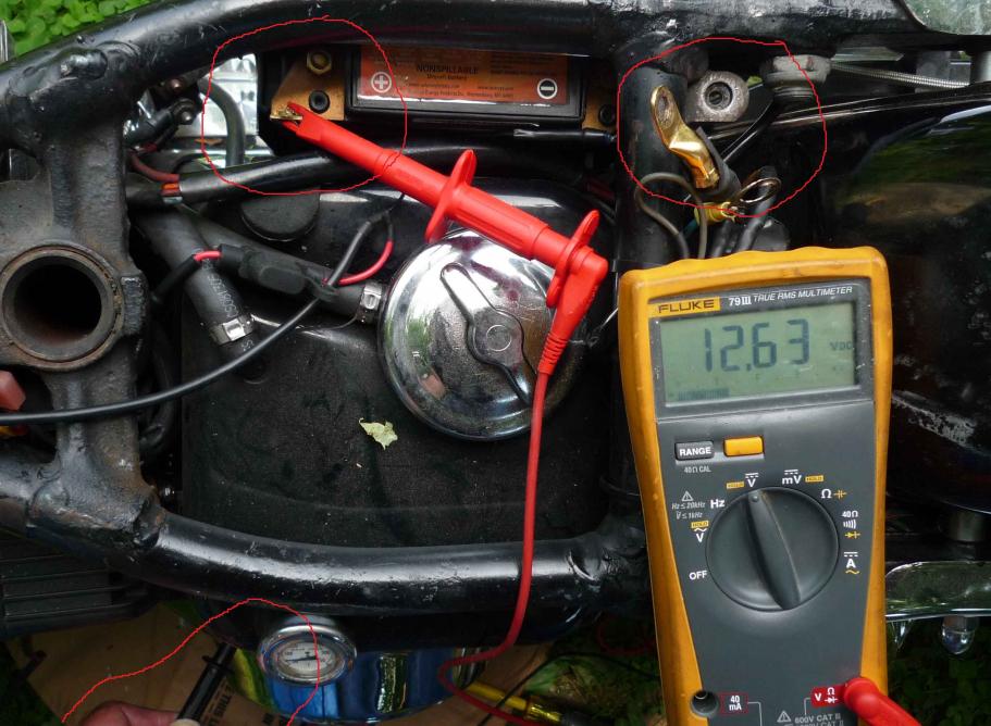

I changed the accel solenoid I was having trouble with I found a NOS OEM HD solenoid, change it out grounded the spark plug wires together from starting, hit the start button (handlebars control changed in ’08), at first in was normal turning over after 5 seconds or so it started to lag or drag, very slow turn, I shut it off, notice I was getting a voltage reading from the starter side of the solenoid to starter (all *****) so I took off the battery ground cable from the frame, it has no contact from battery NEG post to frame of bike (FXS)
Here was when is started to get strange.
I get voltage reading when I touch the POS battery to any ground on bike ?
So I disconnected the POS battery cable for the power to the bike at the battery.
Here it gets even stranger
Battery POS and NEG cables are off the battery
Fluke VOM meter attached to POS battery post, black of meter on Primary cover also solenoid to starter cable (but not on battery side of solenoid because cable is disconnected)
I get this 12.63 V readings on any grounded or POS side of solenoid and to the starter, the starter case shows 12.6V, I get readings without a battery to frame ground connection ?
Also without any battery connections to bike, I get 12.63V reading from ground frame to battery POS post ? I am getting these readings because I am touching the battery POS post to various parts on the bike w/o a battery ground cable ?
I can sure use some help on this ?
Attached is a pic lower left shows probe on top of primary cover, the other side of the VOM meter is on the POS terminal of the battery, no connections from battery, either POS or NEG to frame of bike except for the VOM on battery post.
Any ideas ?

Well here I come with my tail between my legs, for the time wasted with this post, what I had thought no cables were on the battery no POS no NEG ground cables were on the frame, but the smallest thin wire (used as a ground for an electronic device) was on the NEG terminal battery post hiding under the frame, saw it a few mins ago.
Yes stupid very stupid,
Sorry people !!

Yeah the reason for the meter, it turns out to be the jerk that was handling it, aahhh that would be me !!!
I can give you excuses why it happen, the biggest is not paying attention, I am sure many of us went through something in our lives, doing something and not really paying attention : - )) at least those that admit mistakes : - )))
Bill a friend of mine came over late afternoon looked at the battery connections and said everything is disconnected as you said, walking around and looking eye level with the frame and battery under it, smiled and said me, except that little thin wire you have on the battery NEG terminal ?
What f-ing wire to the battery ???, that one !!!
The moment of instant smacked a$$ look come over my face : - ))))) yeah something I just put on a wire to the battery maybe last month, I never at any time almost 30 years ever used the NEG post at the battery to ground anything always the frame, except that thin 22 ga wire, why because I didn’t want to splice and add to that thin wire length !!! DUH !!!!!
