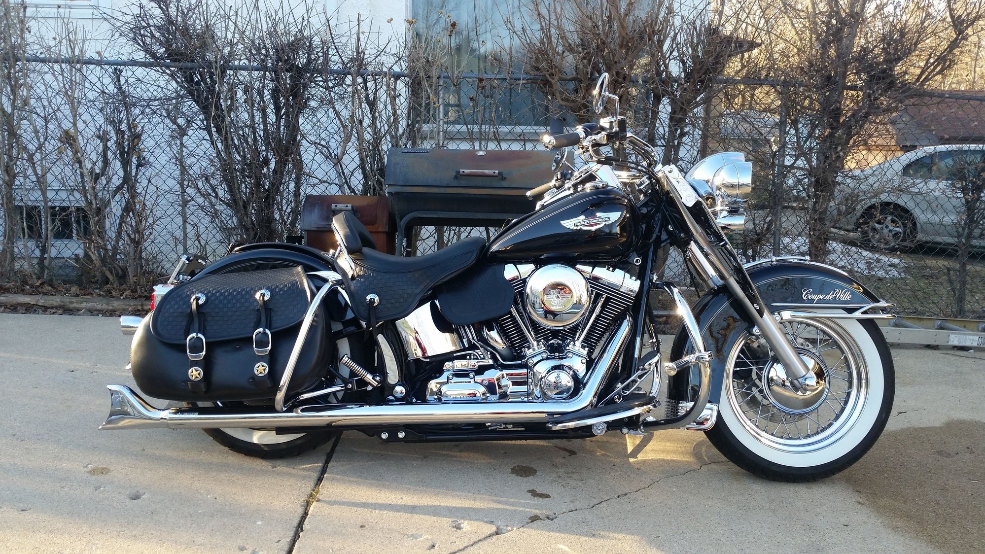

Puts lots of Ape Hangers on different models but this time it's 36" wide Beach Bars on the DeLuxe, usual question, what's the chance the stock brake and clutch will work? I have a spare set of 4" wire extensions handy from my FatBoy if needed, just was hoping I could get away with stock clutch and brake lines. Anyone mount 36" wide bars using the stock lines on an '11 or newer DeLUxe??

On my 2010 I used the shortest risers (1") and all my stock wires and cables brake line worked no problem. I did not internal wire them. Drilled holes on the bottom and used the factory style push in plastic wire holders. If I had used any higher risers it would not have worked. Pic is the only one I have on this computer can't see much but a good excuse to be a pic *****.
