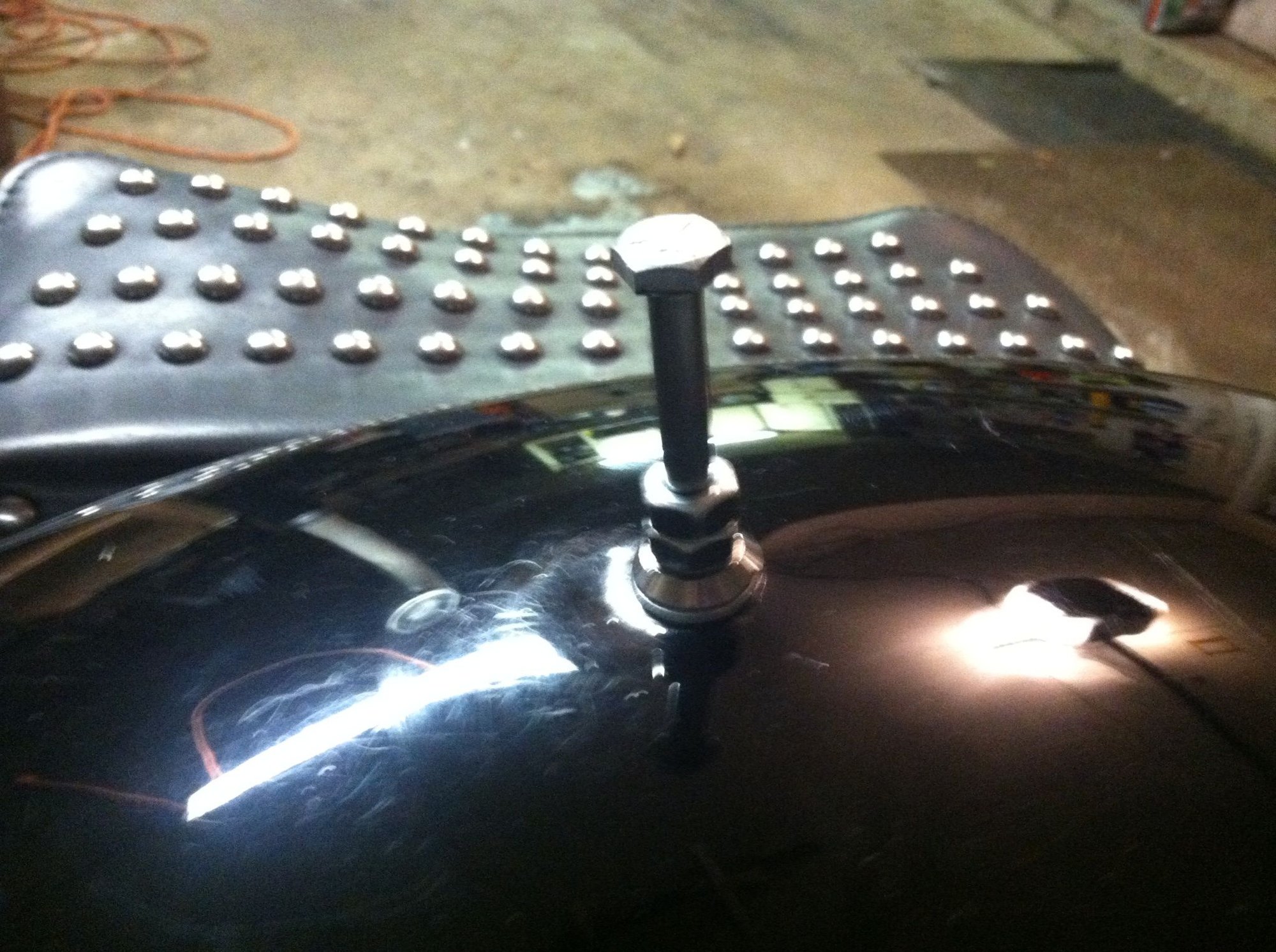

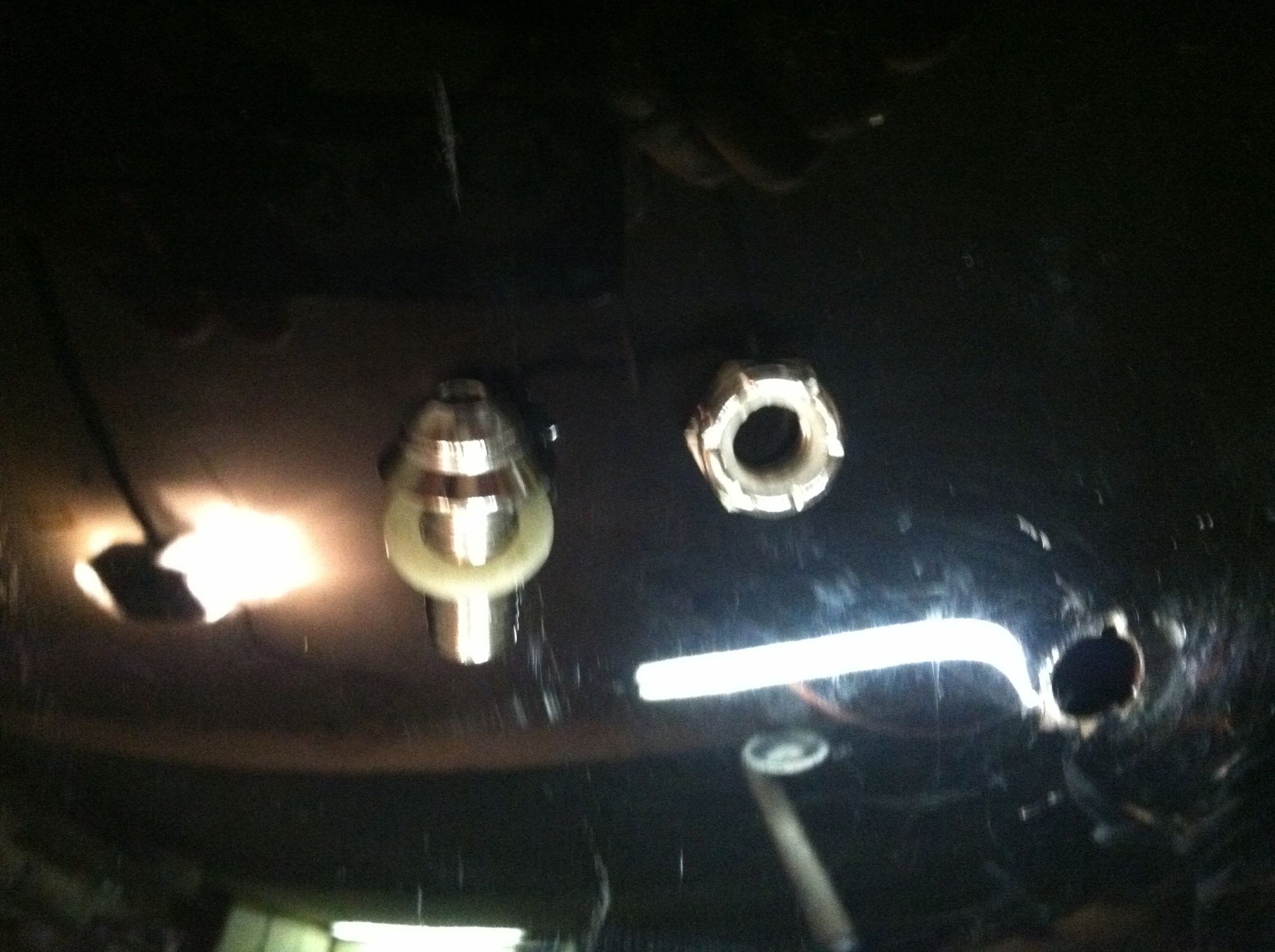

Thanks for all your information ! Tom84FXST! I ordered the bolt and screw from Moto. This seemed to be the best looking as the nut and bolt are chrome. I appreciate all the help. I'll post a photo of the application.
Old Jul 25, 2015 | 04:42 PM
cimnut's Avatar
cimnut
Posts: 52
From: New Lisbon Wi
This product worked great! Easy to install. Need a long bolt and two nuts to lock the base while tightening the base. If you use just the screw that comes with it, you will back the lock nut off trying to remove the screw. Thanks again!
