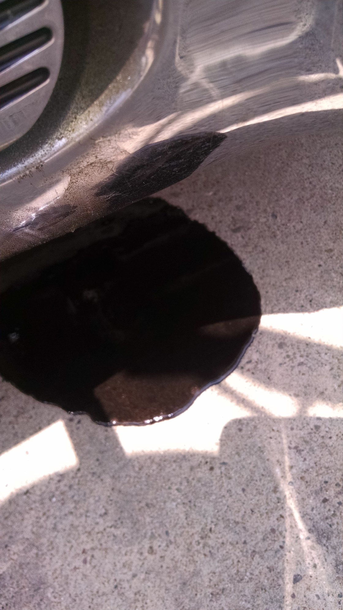

i have a 1992 heritage and its leaking oil out of the back exhaust and and first when i started it there was a whole pill of oil on the ground any answers thanks guys

No idea whats caused it but the oil looks like its been in the bike since 92.

Any chance that you can post photos with a wider view.
Are you looking for answers regarding the poor looking state of the oil, or the possible source of the leak?
The it blow loads of smoke out the exhaust when you got it started, did it run fairly OK?

It starts fine I'm wondering why the oil is coming out of the exhaust it's only dripping now from the exhaust it's not pouring out

Oil leak is not a good thing. Oil coming out of the exhaust pipe is even worse.
The oil is probably getting past the piston because of bad rings ....... Like Blueraven mentioned.
Don't know how mechanically inclined you are. I would take off the exhaust and look into the exhaust ports on the engine. See what that looks like.

What part of the exhaust is the oil dripping from, near the port, or the tail?
Does it smoke when running?

Near the port and no smoke out the exhaust
