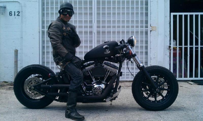

Hey!
uhmm.. fenderless .. as you can imagine riding in the rain is a terrible experience!!.. is all about the looks..
funny thing is that I remove so many heavy parts from my bike that it actually handles better.
BTW.. that is an old pic... this is how my scoot looks now
