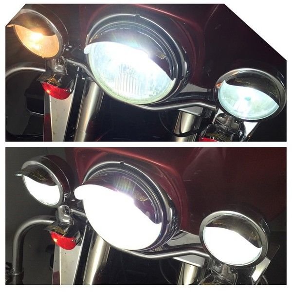

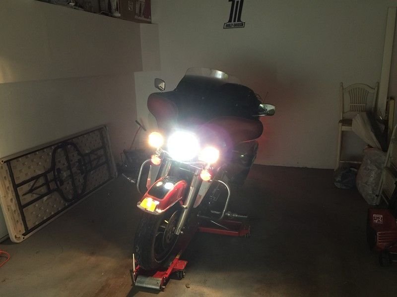

I have this in my headlight:
http://www.cyron.com/p-209-headlight...les-abh4k.aspx
And these in my passing lamps:
http://www.cyron.com/p-213-fogpassin...ab881-a6k.aspx
I've had them in for about a month now and I can say they're BRIGHT. For about a hundred bucks I have an all LED conversion solution that can still accept a bulb from any autoparts store should the need arise in the future. Can't beat that!
Top is showing the difference in the stock halogen passing lamp vs the LED bulb.
How it looks during the day, didn't have the passing lamp LED's yet.
How it looks at night, didn't have the passing lamp LED's yet.
