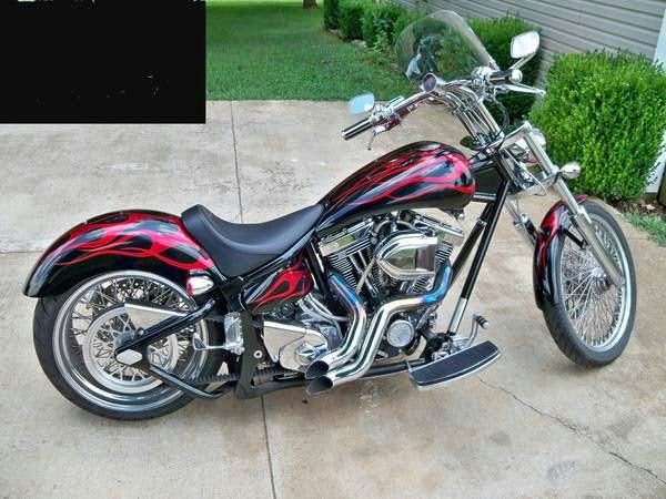

Well,I gotta start somewhere
I've got a sweet custom built bike
It's built on a 2006 softail frame
Stretched 4 inches and raked at 37
While I like the bike...it's in for some changes!
I really miss my decked out deuce I had years ago
So.....my goal is to make this baby as close as possible ..
Although. ..it will be raked and stretched
She has an aftermarket electrical system (wire plus)
80 spoke wheels21x2.5 in front and 18x10.5 in rear
S&S 96 super stock..Evo style
Baker RSD 6 speed
To start...
I'm looking to do a nice 2 up seat
Maybe change tank
Factory Harley electrical system
Pipes..really like the vh radius. ..
Anybody have any idea's on this?
I'm sure this is out of the ordinary. ..but what the hell
It's paid for and only has 1600 miles on it!

Sweet bike. While it's not my style I can still appreciate it for what it is, and I can see a lot of potential there! What sort of style are you going for? I think you can defintely do something better with the tins and seat. The big radius is a nice pipe but it's really over used, it seams to be the most common pipe ever made. Being such a custom bike, it deserves something cool

Looks like the fender is drilled for a 2-up seat, but you will be limited on what seats you can use because of the stretched tank...and you may find the strutless fender kinda flimsy 2- up.
As far as changing tanks, you will be limited on what tanks will look right because of the stretched frame.
What is wrong with the present electrical system? Kinda lost on what you will gain by changing.
Your exhaust choices will be limited by the right side drive.
