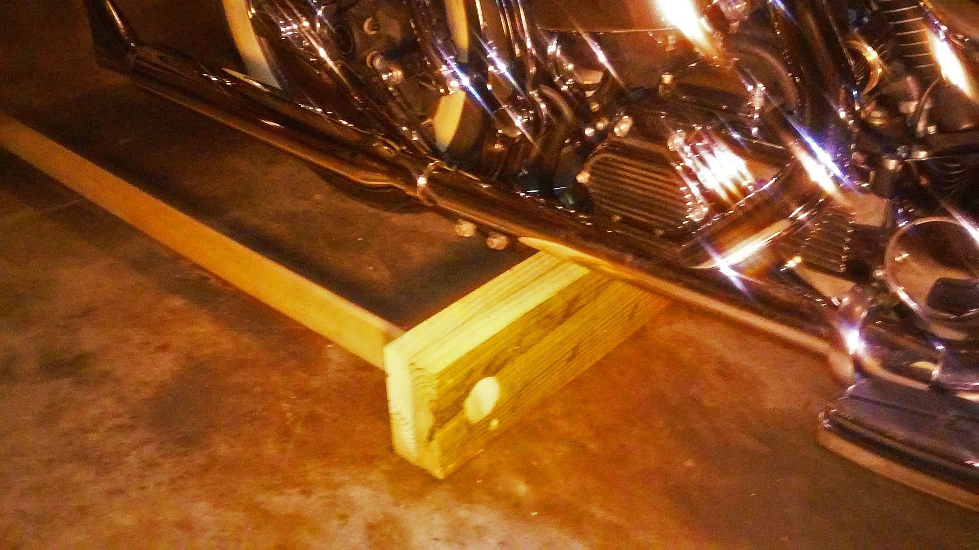

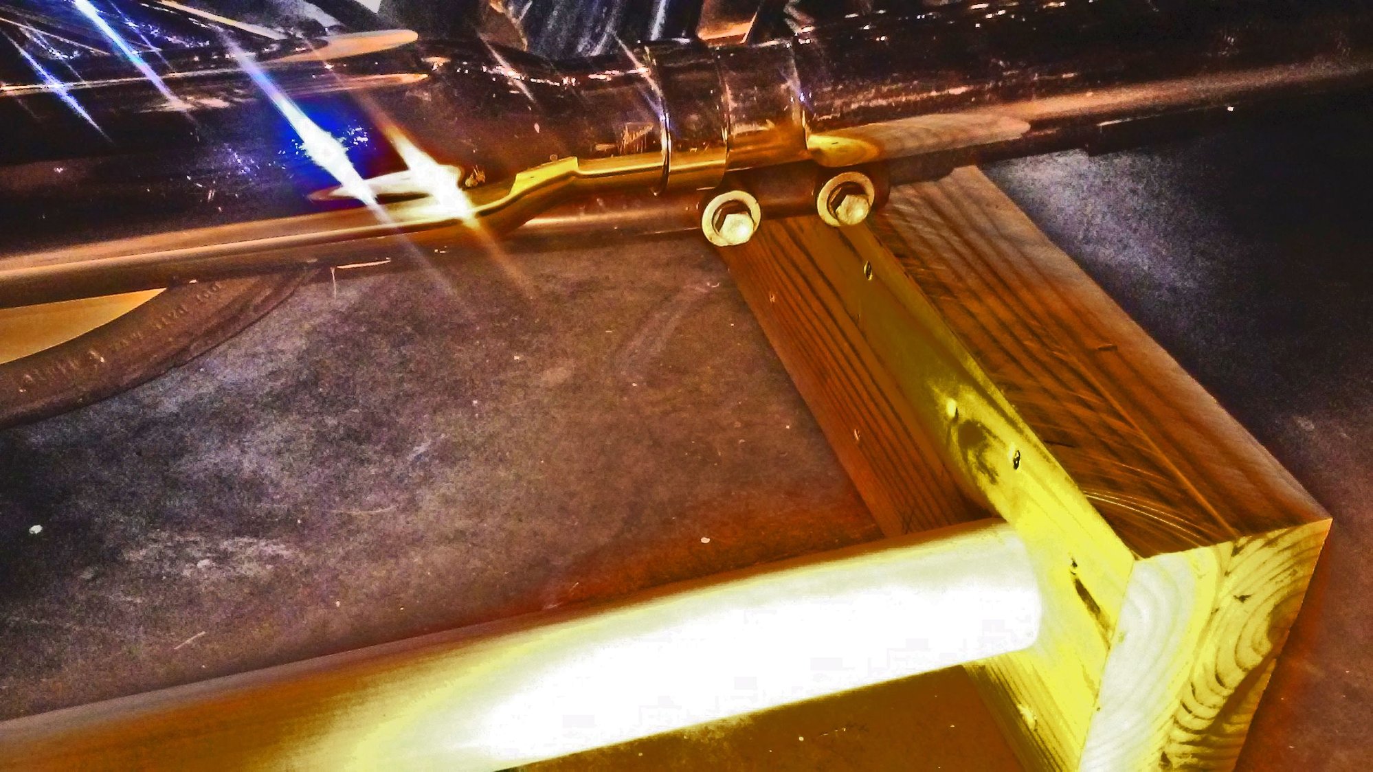

As the proud new owner of an old, used Softail, I need to get maintenance up to date. It's been a bitch so far because the previous owner lowered the bike, and my red Sears Craftsman motorcycle jack wouldn't fit underneath. So I goes and builds a simple homemade wooden jack that gets the rear wheel off the ground far enough to allow the Craftsman jack to slide completely under the frame. Only now, one lift arm of the Craftsman wants to contact the shock absorbers underneath and I can't reposition it rearwards because my homemade jack is in the way.
Question:
Are the shock assemblies strong enough to support the bike or will they be damaged if used as lift points?
