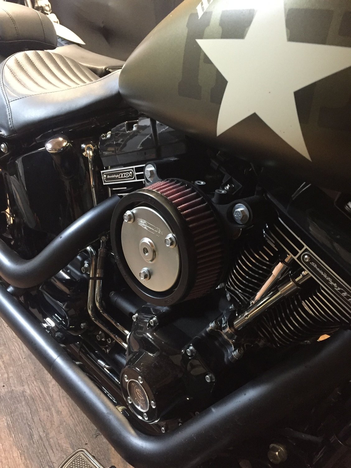

Have a 2016 heritage and from what I read the newer air filters have improved in air flow over the older ones.is it worth changing out to a performance cleaner on a bike with slip on mufflers and very mild cam.

While the air flow may have been improved a bit Harley is still routing the nasty, hot, oily, oxygen depleted crankcase gas back in to the A/C which isn't the best thing you can be doing to your engine. Replacing the A/C with one that allows you to vent those gasses to atmosphere will certainly help with performance and longevity of your engine. You can find multiple options and configurations that do vent to atmosphere HERE

DK custom outlaw air cleaners are legit. Plenty of happy customers. Plus, that fancy looking o.e.m air cleaner cover will look good hanging on the wall in the garage

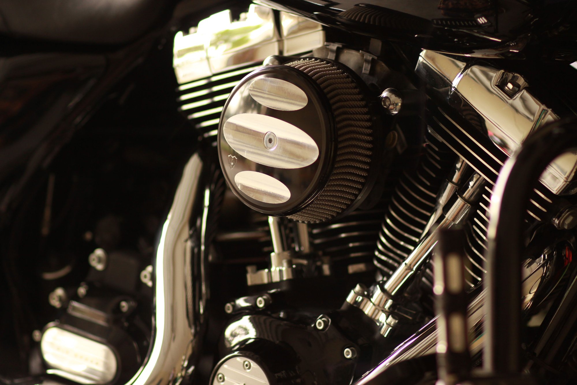

Anybody know is the Arlen Ness Big Sucker Stage 1 vents externally?
Don't know the answer, but I sure know it looked and sounded good on my Street Glide.
Bug Sucker
