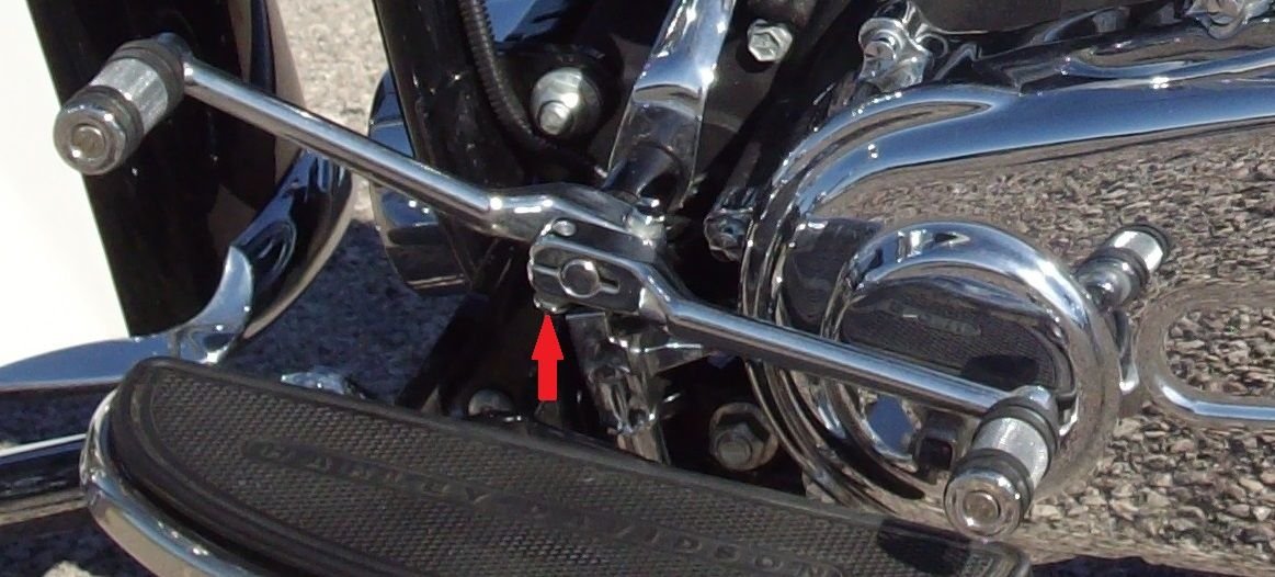

Originally Posted by Bone Doc
Welcome to the forum from Texas. I use mine all the time as well.
Loosen the bolt indicated by the arrow and work the heel shift lever off.
If you want to cover the exposed shifter shaft, Harley makes shifter shaft covers:
1. HD part 35471-05
2. HD part 35495-06
Exactly what I did just this past weekend. I was looking at swapping out the boards for forward controls but, after seeing that was a very pricey option for the Lo I just ditched the heel shifter. With the exception of scraping the boards on every damn turn, they are way more comfortable than pegs.
