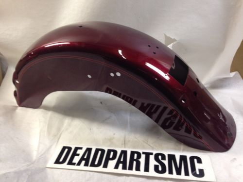

Originally Posted by SoloMC
I wanna say heritage rear fenders have a stamped inlay in the metal for the rear tail light mount. where the deluxe does not. So body else might chime in with more info .
They will mount to each other's frame . However, the tail lights of the fender you chose will need to be ran with it.
Correct. Additionally, the Deluxe has a square mounting block for the tombstone taillight and two square indentations under the taillight where the turn signal bar mounts and two additional holes that the signal wires go through. HTH.
Fatboy fender...
Heritage fender...
Deluxe fender...

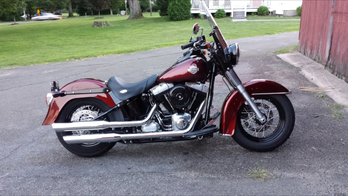

Default Slim with Heritage or Deluxe struts
This Slim posted by a Forum member...
It has been a while, but I think he has a Springer rear fender mounted with late model (2006 or so)? Heritage or Deluxe struts.
@ 2005 or so? Harley got rid of the welded to frame struts, and made the the steel under the chrome (black painted in this photo) struts bolt on as well.
