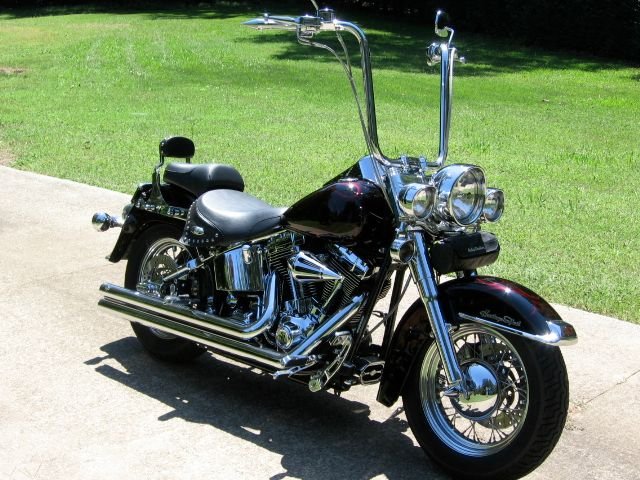

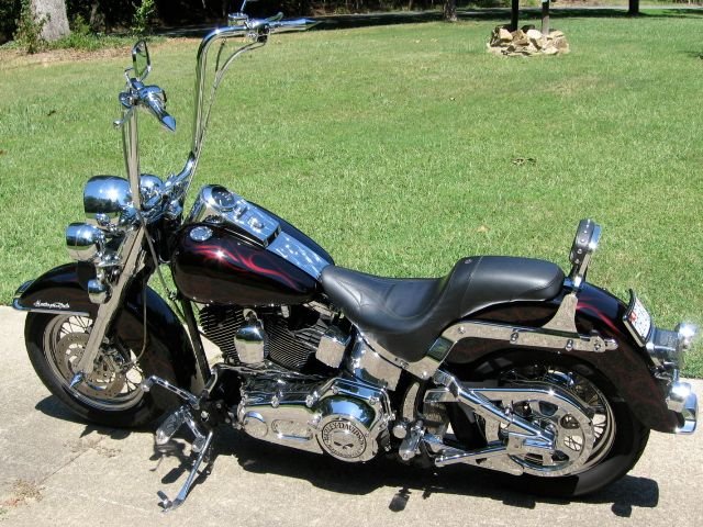

Good advice all around. But in looking at your pics, it appears to me that your not having to reach very far to get the hand grips, your just placing your hands up and probably your elbows are bent and just hang there. One of the cheapest (and I mean $0.00 cheap) would be to loosen your riser clamp and push your bars forward some. Having had 18" apes in the past, I found that having the bars forward of the forks forced me to reach a little and straighten my elbows, it would keep my back straighter and sat me more upright, which should provide more comfort and relieve the stress on your back and shoulders (and make the bike look a bit more aggressive in the process). You could also try to purchase a used Heritage seat and save a bit of $$$ before dropping a chunk on mods, I found that the stock Heritage seat is built with a little bit of height already built into it, which will also contribute to the comfort factor. Now, if that doesn't work, then you lose $50 or so on the used seat, but it might be worth it if it DID work out. I've included a couple of pics of my 2004, not sure if you can see difference in the seat but when I went two up with the stock seat there was a noticeable difference.
Heritage Right Front Angle
Heritage Left 2
