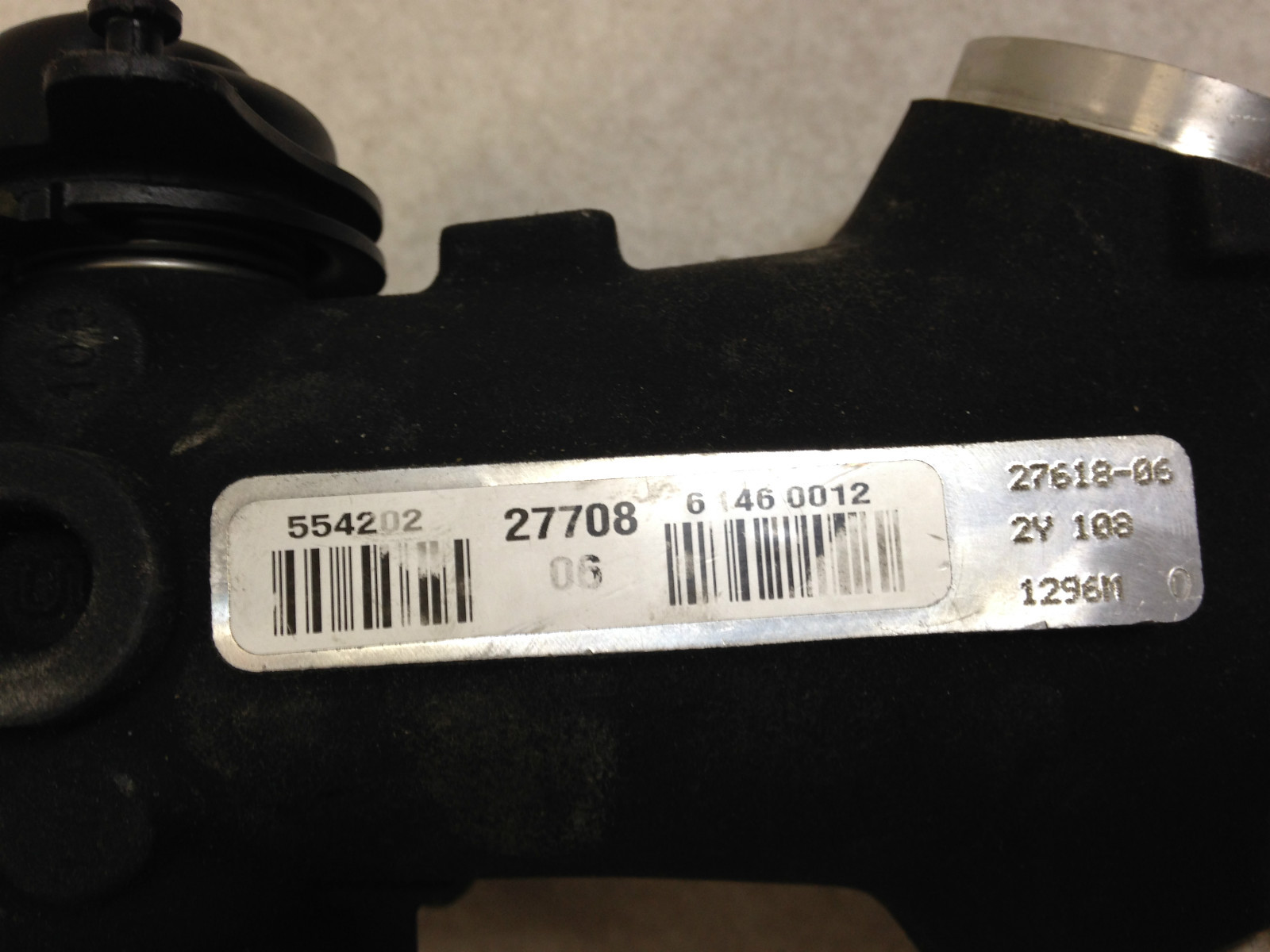

Hey LA,
What's the part number for that throttle body you had machined?
I found one on eBay. #H-D P/N: 27618-06

From: Oregon Illinois
Or maybe this one? H-D P/N: 27641-06

From: 90210
I got this one: 27708-06 / 27618-06
