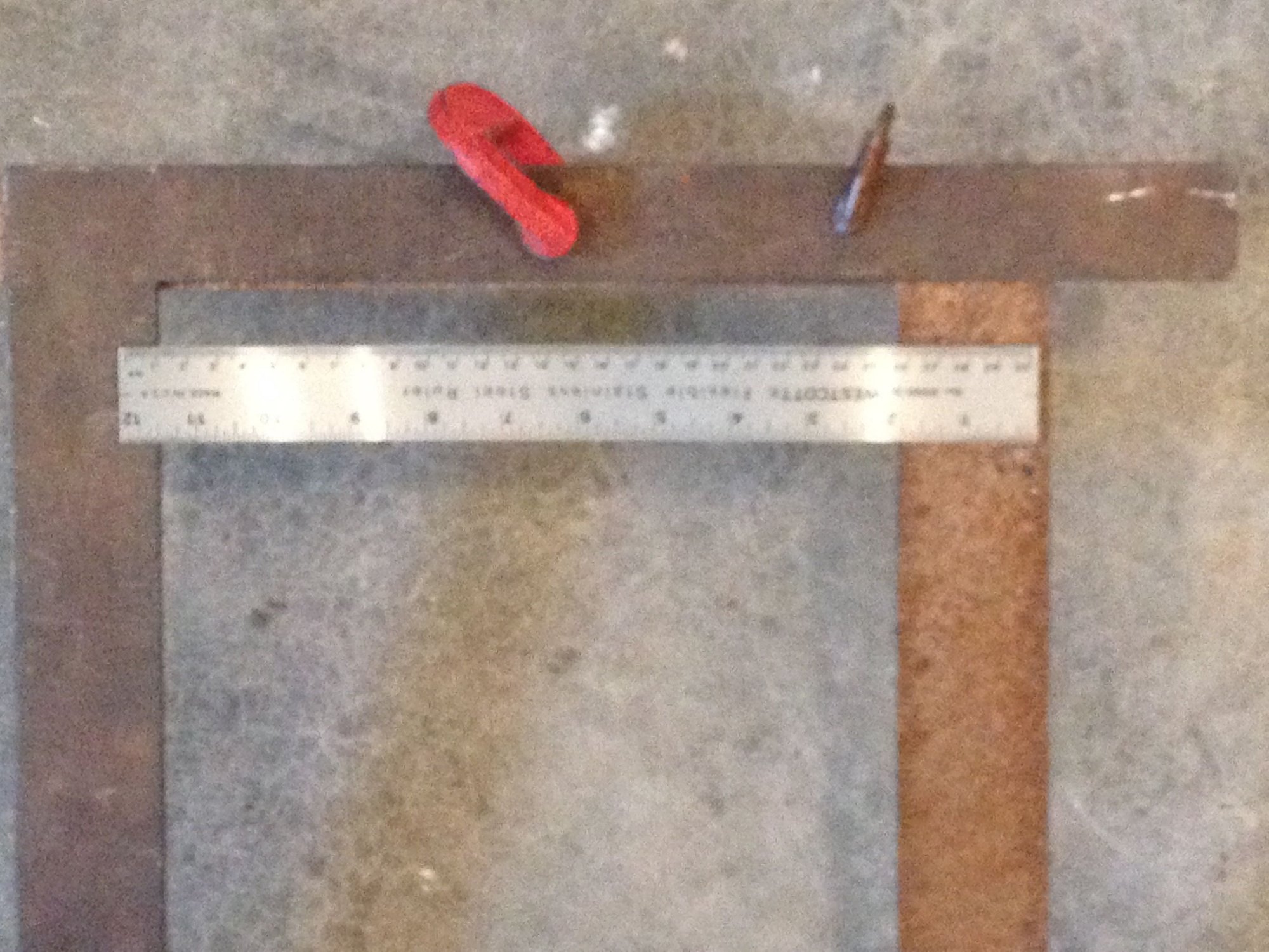

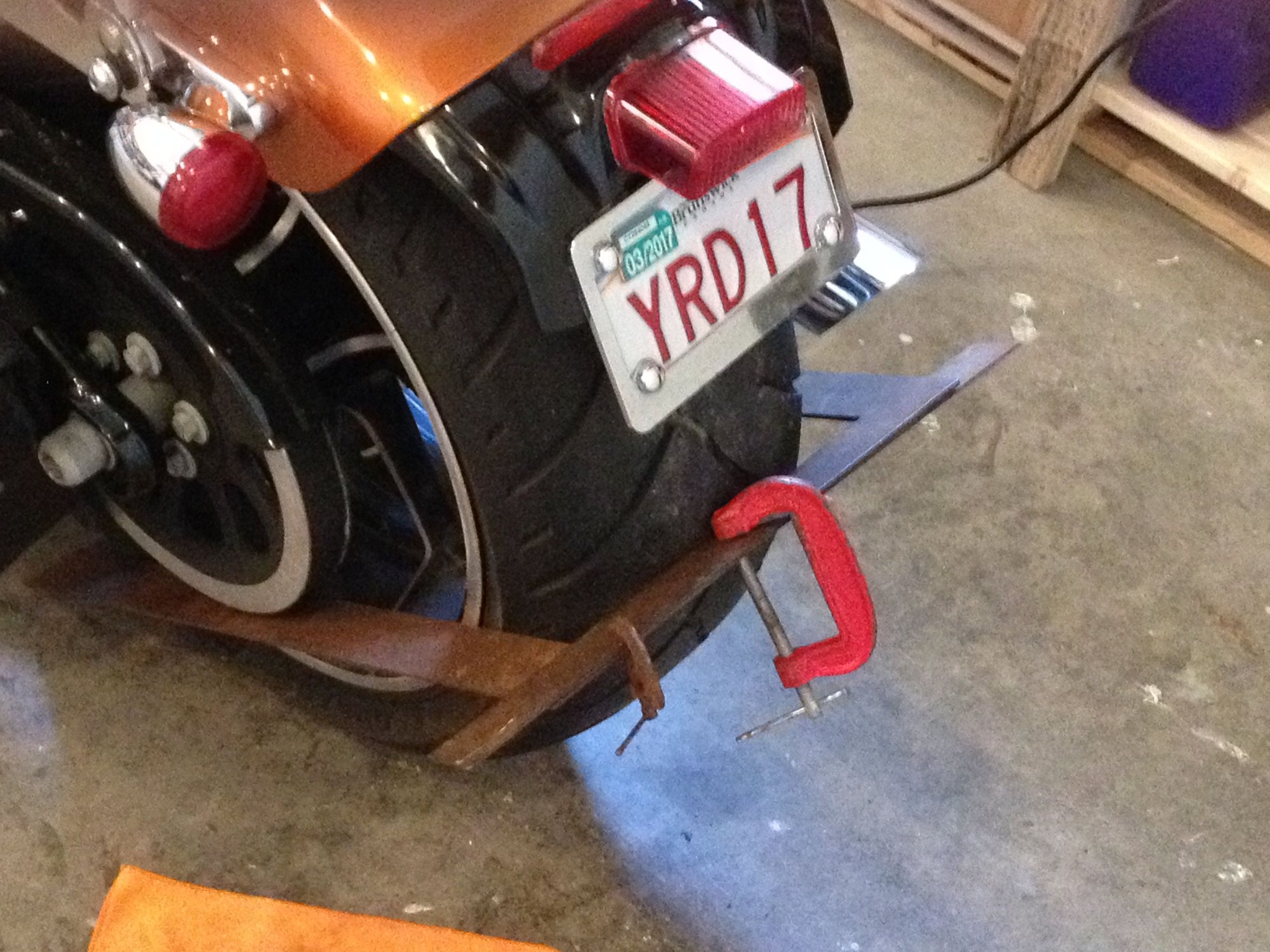

OK, I got off my lazy *** and invented the Redneck Tire Caliper, frozen Redneck style, (patent pending).
The method:
The measurement (subtract 10 mm):
The result (subtract 10 mm in case you missed it the first time):
So, 246 n-a-tad is the width of a mounted E3 250.
OK, you win. Some of you guys pretty "detail oriented". My method was not as sophisticated.... But I measured 251mm. I was trying to be as careful as possible to get it right but it was 251mm. This is mounted on a stock Breakout rim. The difference could be explained by a difference in tire pressure between the bikes, we are talking only a few mm's. I posted on the Everything Breakout thread on my install. All I can say is the bike handles way better with the E3 vs. stock. I am talking it took me by surprise when I first got on. I am sure Metz and Avon are also very good.
