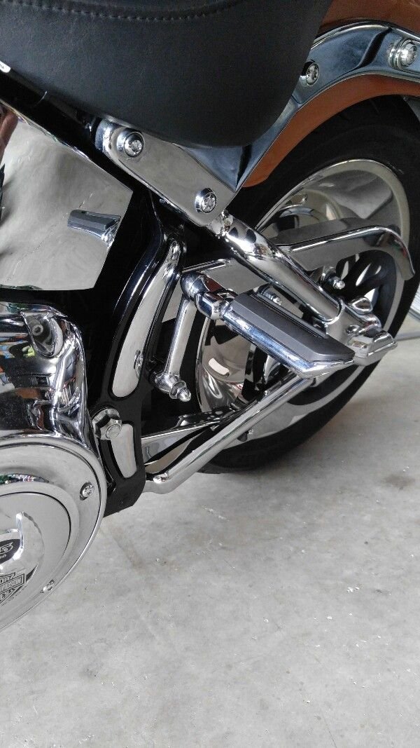

Old Jul 7, 2016 | 07:12 AM
chrisarrington's Avatar
chrisarrington
Joined: Jul 2011
Posts: 72
From: Seymour, TN
This is what I did for my back pegs. My wife is short and the angle of the rear section of the custom seat was putting pressure on her hamstrings. She said that it is night and day difference now.
Old Jul 7, 2016 | 03:56 PM
duster44t@aol.com's Avatar
duster44t@aol.com
Joined: Mar 2016
Posts: 57
From: Greensburg, Pa.
Those would work.....where did you get them?
